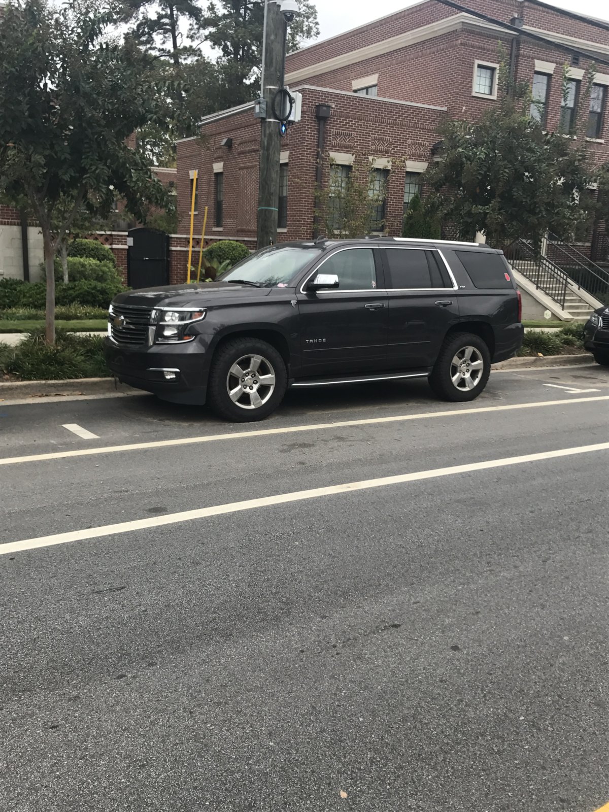

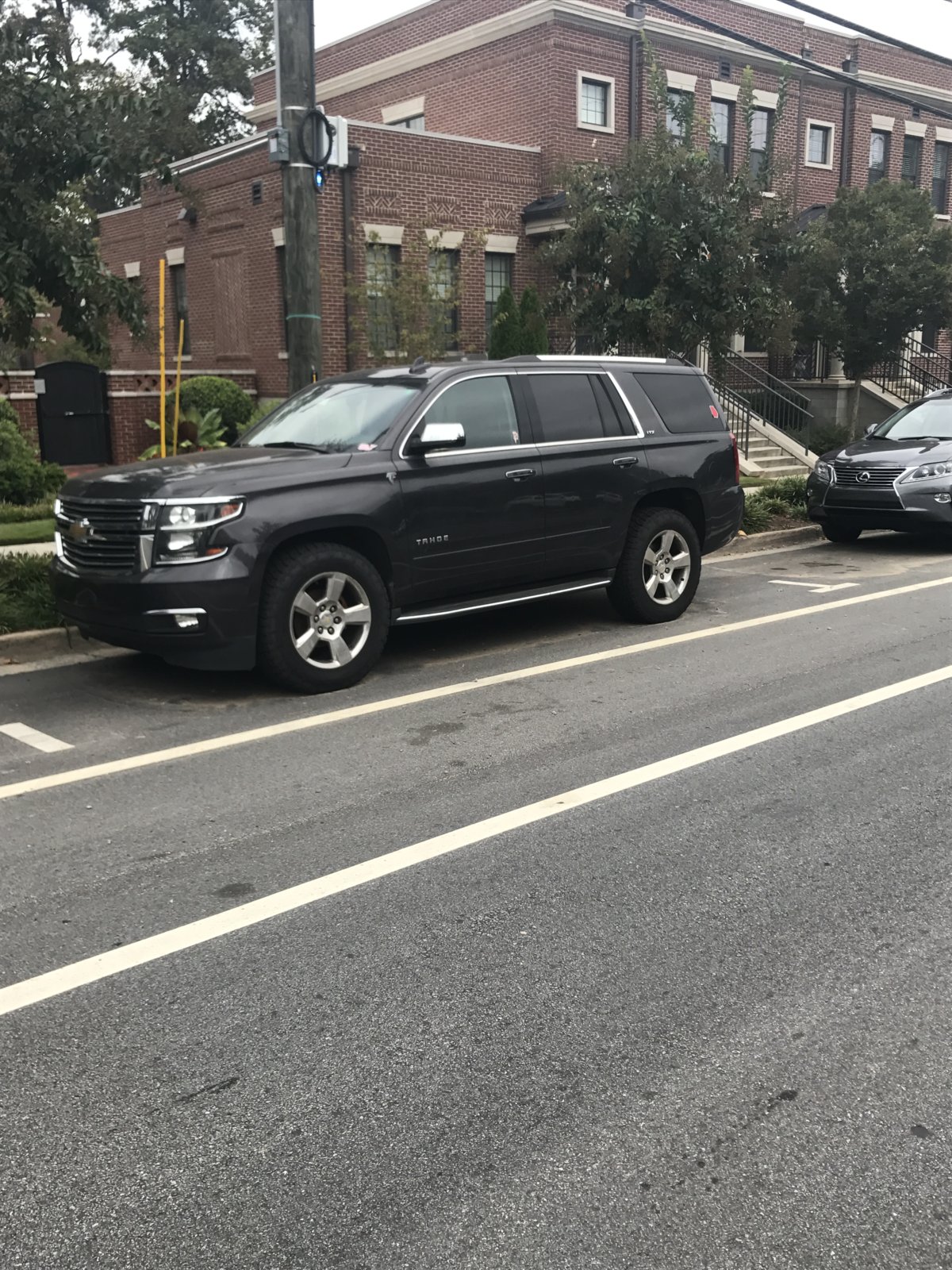

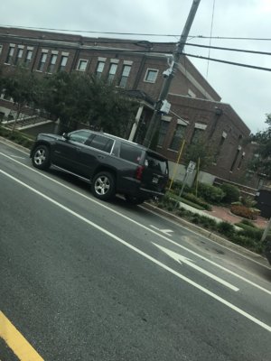

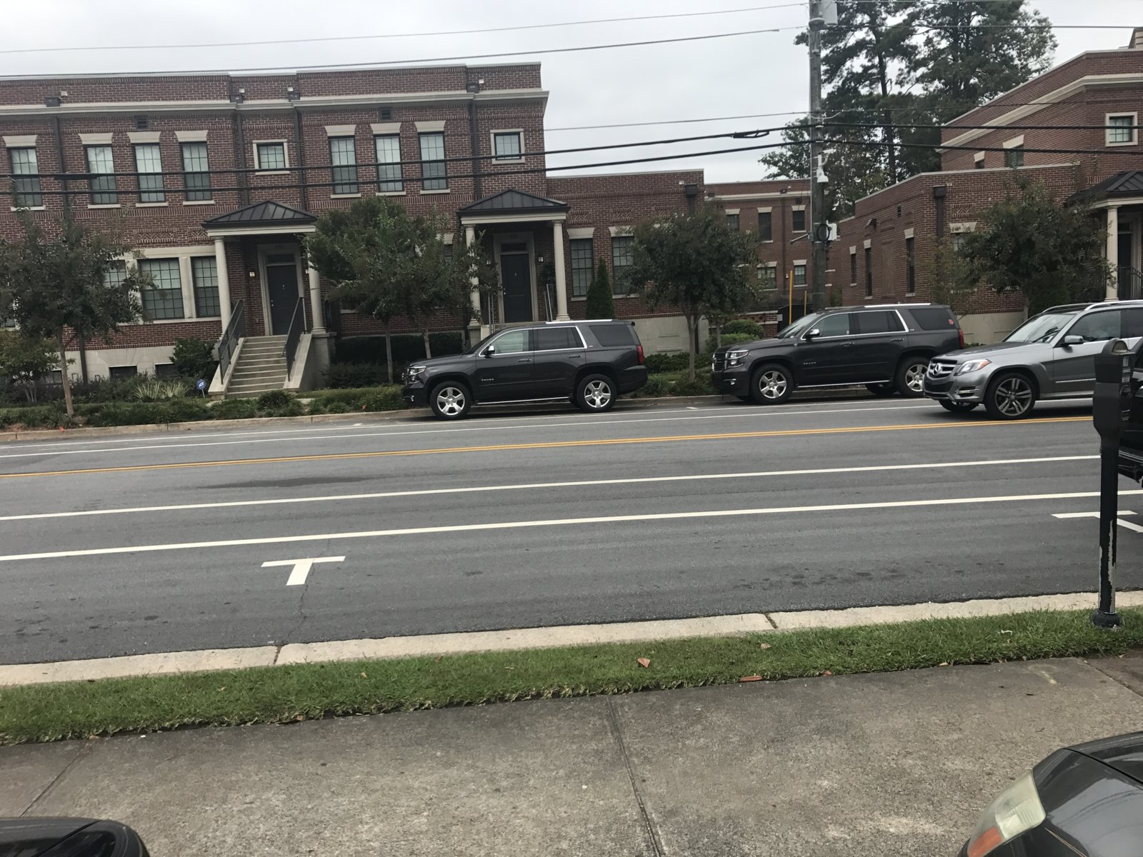

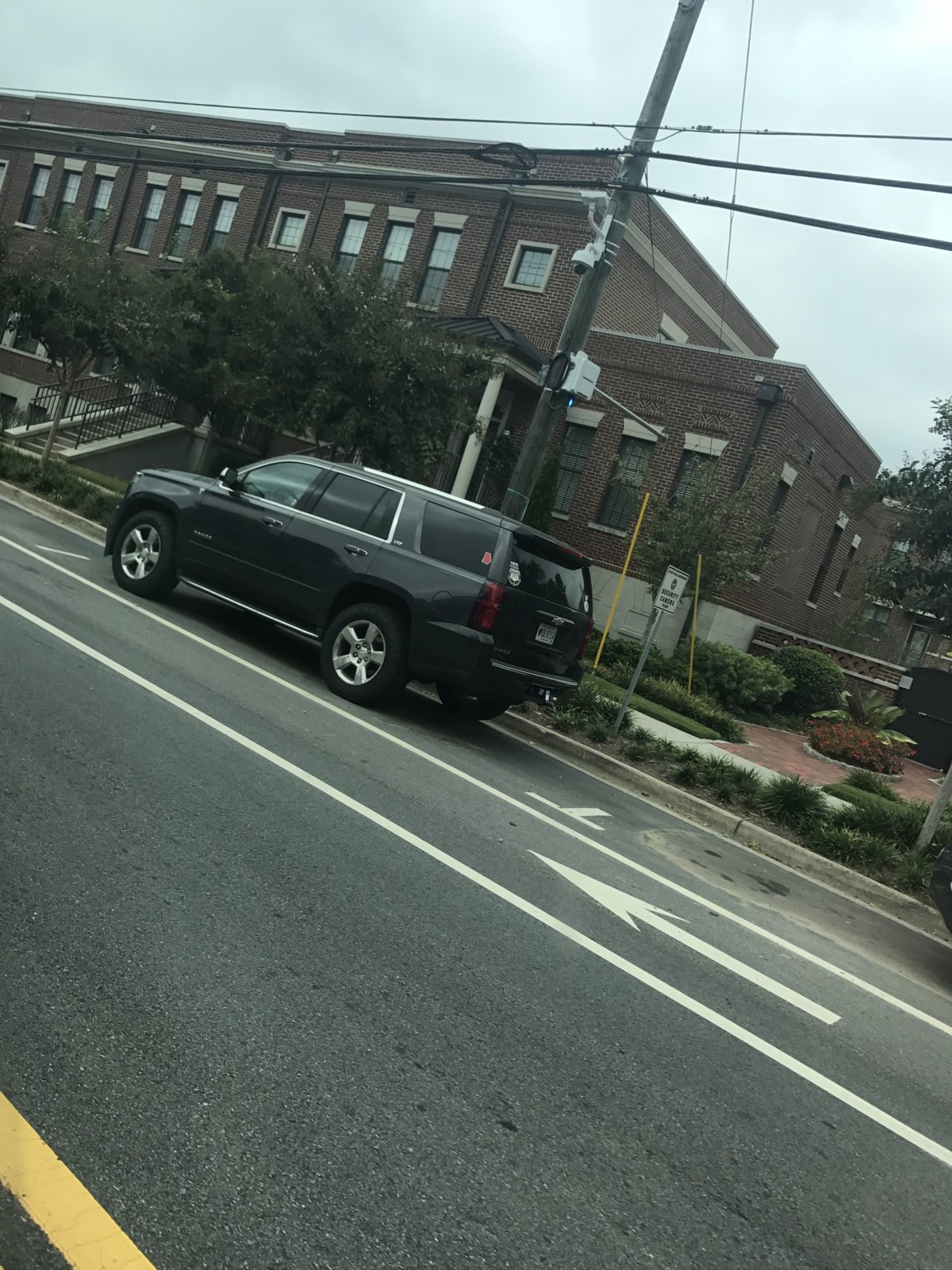

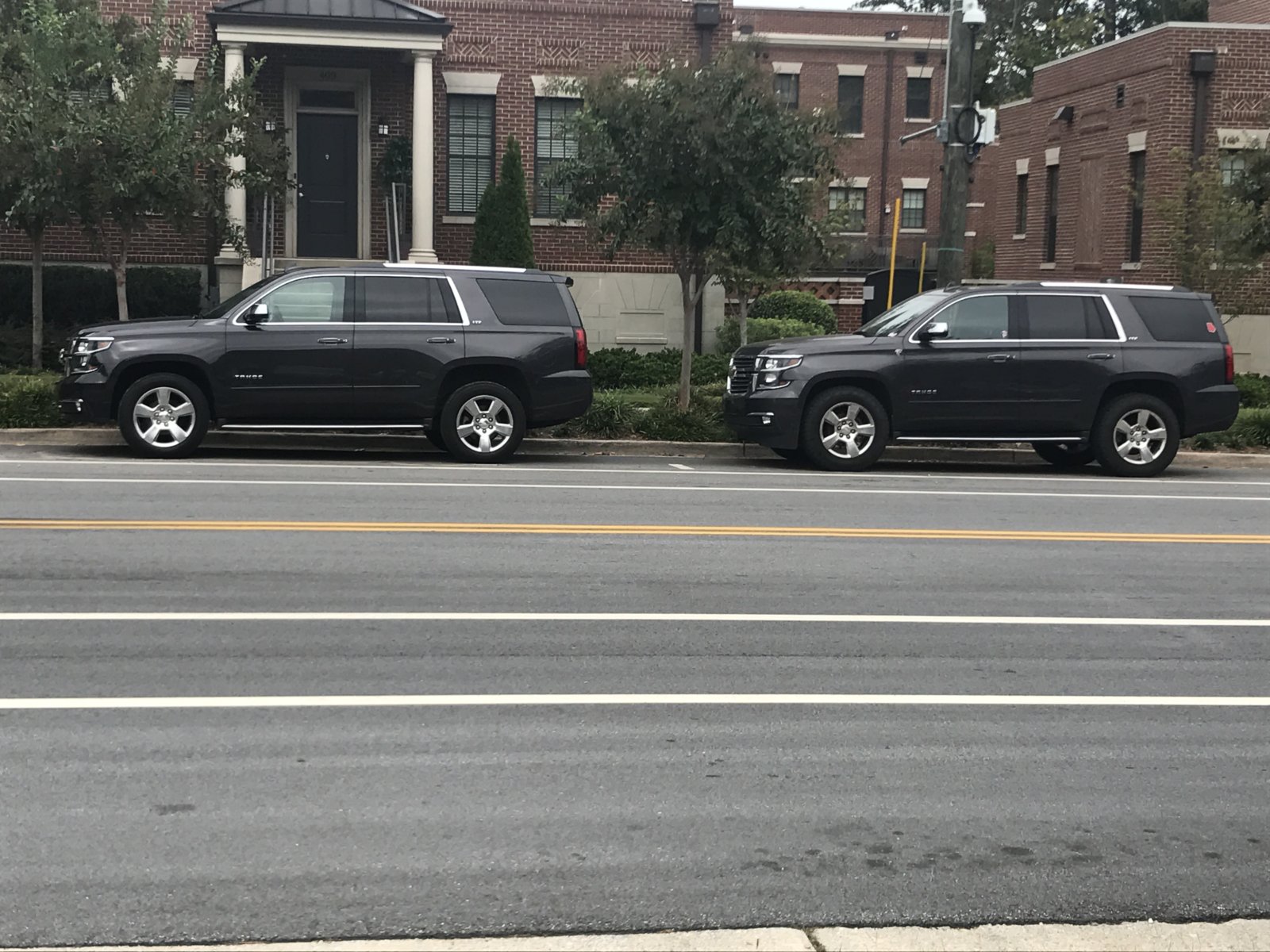

Pics are attached - he has to rub..
Demer
Feb 26, 2016
118
65
Eagle, ID
Yeah, that does look like it may rub... but it looks so good!
