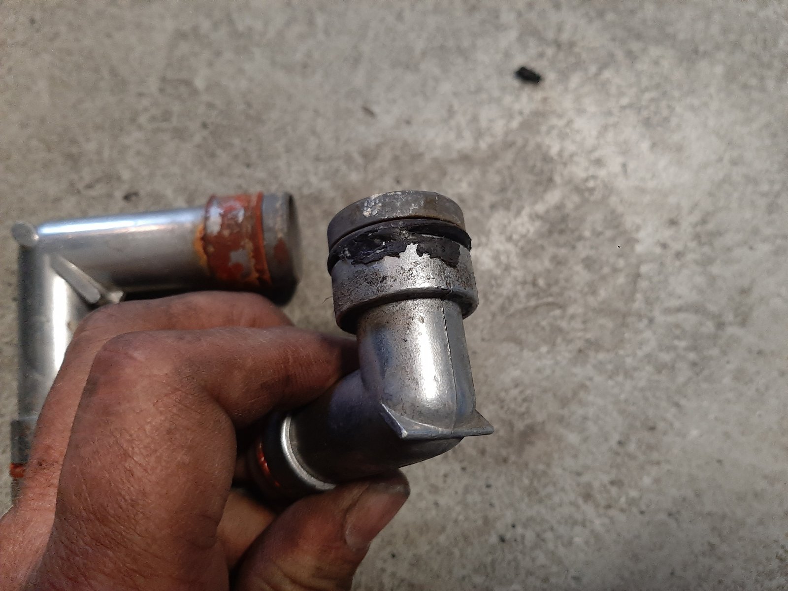

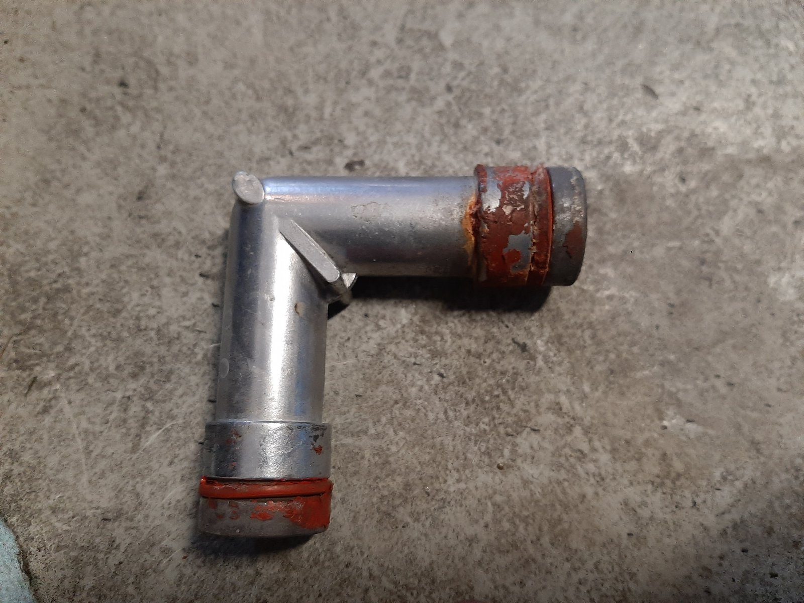

One step closer, the heater core elbow directly above pump has water under it. I'm not sure if it's the elbow or the gasket.
Hopefully UV dye can sort it out. I recently replaced those elbows with aluminum *ahem* Dorman parts. I like that they are metal instead of plastic. However, Dorman doesn't exactly inspire confidence. I really cannot figure out how to easily distinguish leak from the elbow or leak from the intake gasket. They are so close together. I don't appear to be leaking anywhere else between the upper and lower intake, and there's no coolant getting in the combustion process (at least judging by exhaust).
I have also regularly maintained my coolant system. Changed fluids, etc. People seem to think aged DexCool coolant corrodes the gasket material. Right now though, I'm running mostly water because of this issue.
