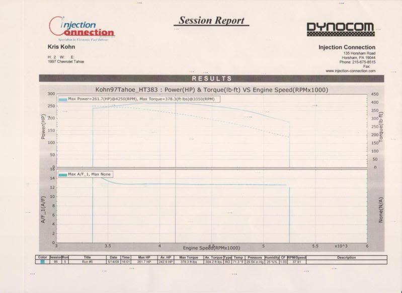

Please post dynos.
I'll dig them up tonight, here is a summary:
Before a custom tune, I had a hyper tech programmer so the before is with a hand held program:
Before:226.6HP 297.3ft lbs at the tires
After: 261.7HP 378.3ft lbs at the tires
Well worth the tune, the numbers don't lie. Factor in a roughly 24% drivetrain loss and you get a motor with about 350HP, close to 500ft lbs of torque. Again, not bad for a reliable motor.
