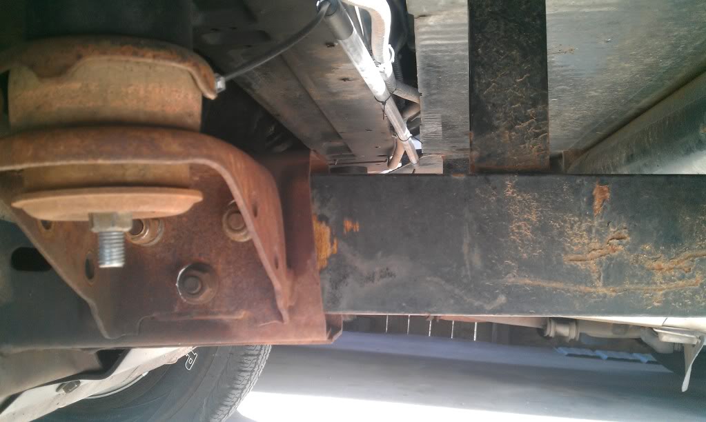

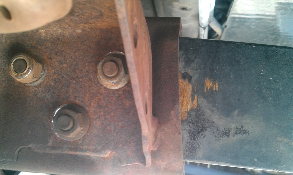

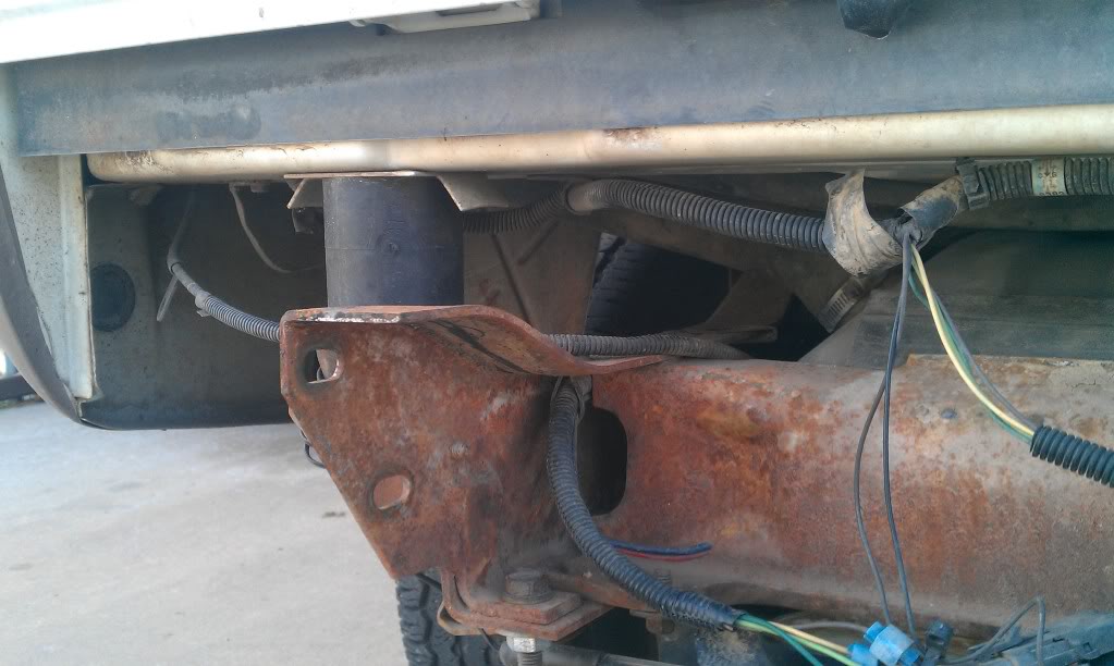

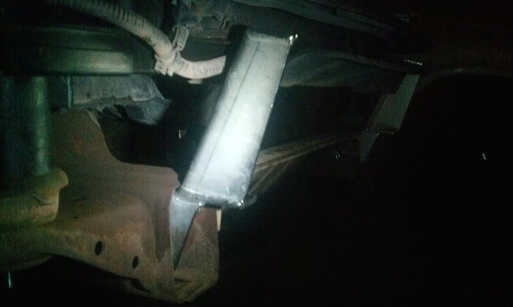

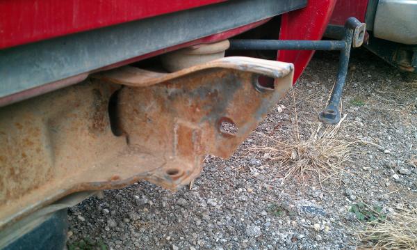

There are no brackets to raise the rear bumper on a 2 door. The frame will have to be cut and rewelded. I did this on my 2 door to raise my rear bumper.

If yall need lics let me know and i can snap some i have my rear bumper off right now aswell so can show more pics of lretty much everything. Note for the front if you upgrade to cattle guard yoy cant hse the lift brackets you gotta keep it down

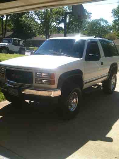

Yeah im going to run the stock wheels that on my picture xD how dos the 295 /75 16 treat you with the body lift? You wouldn't have a resent picture your you're hoe my chance would you?

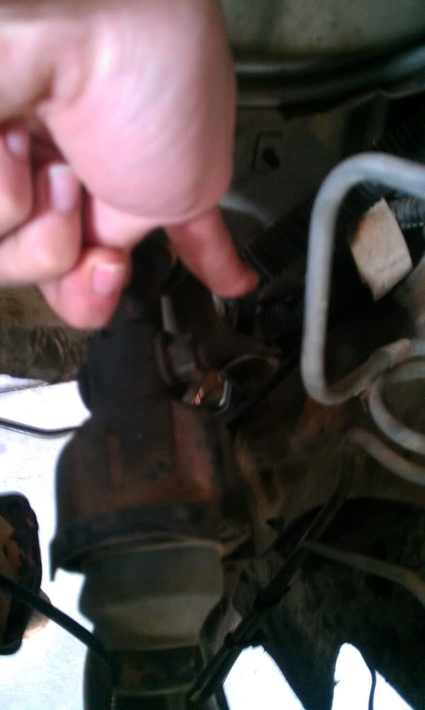

To check for the shift linkage open the hood and look like next to the booster and see if you have a rod style shift linkage. If so its easy to take out and cut and weld. Later on ill get some pics for ya
