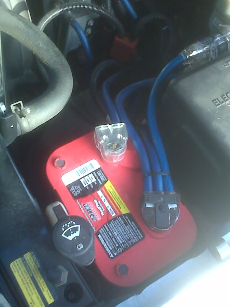

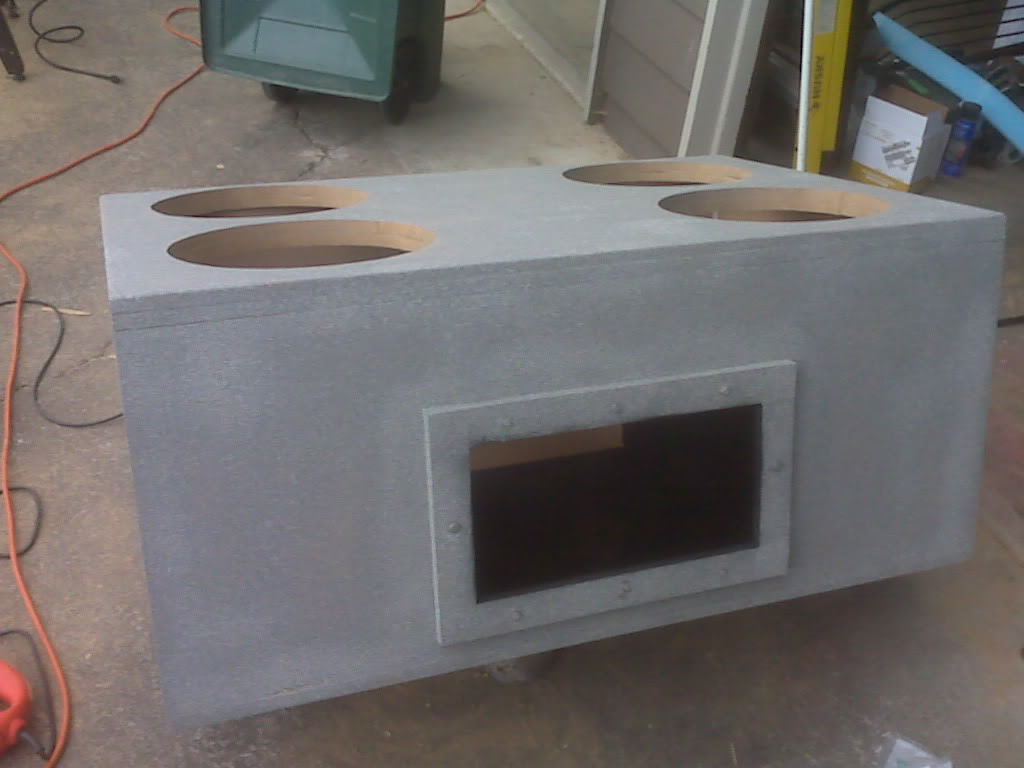

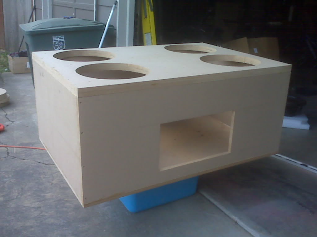

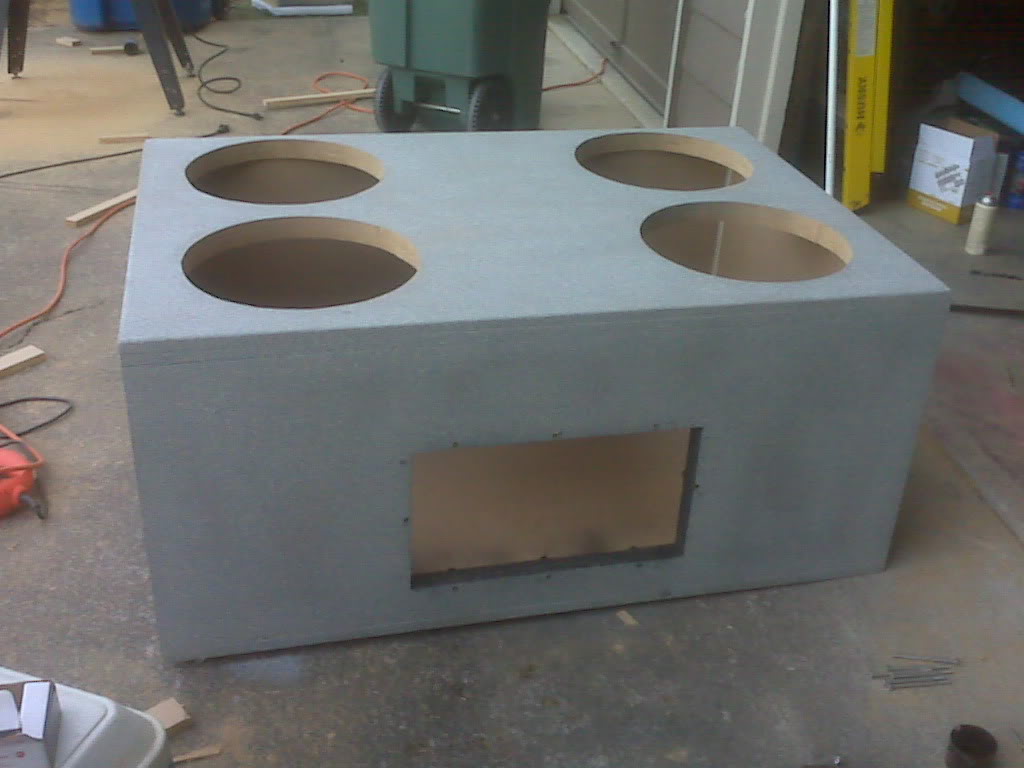

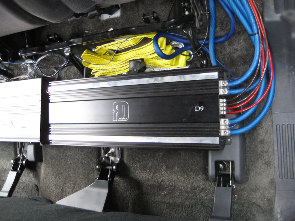

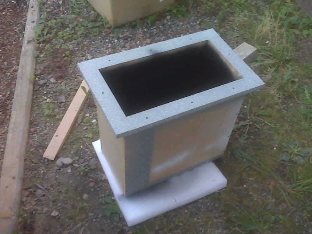

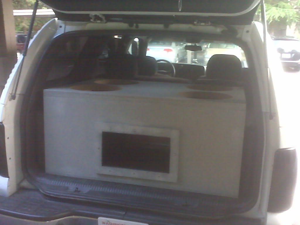

Build I just finished for myself. 4 15'' DC Lvl 4's w/Lvl 5 Coils. RD Audio D9 (5400rms @ .75) I have it wired to .5. The box is around 16 cubes. 45hz port built into the box and a 32hz daily port I slide into it. 1 redtop, 3 kinetik 2000's, Powermaster/Mechman built 240 amp alt. 2 runs of shok industries 0 gauge.

damn nice set up bro! dont have the funds to do anything like that with mine haha but keep up the good work!

what u think its going to hit
I have no idea its always hard to judge what the TL is gonna show lol. My buddy in Oregon is shipping my TL back to me today so well see when it gets here. Im hoping for 51's on music with the 32hz port in and who knows with the 45hz port. I haven't even heard this setup with the 45hz port.

Lookin pretty damn good. Want to do this with my truck someday, but need a lot of funds to do it. Hair tricks???

Looks like your back windows are going to blow out!!
