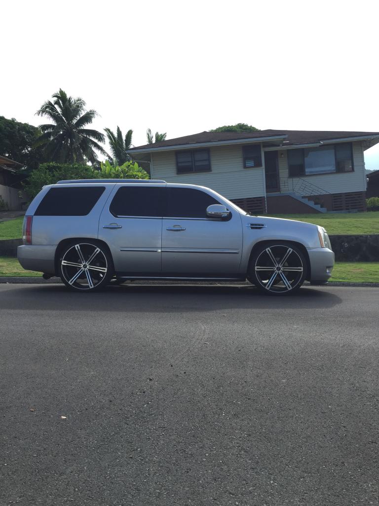

looks great man!!! 295 25 26?!
---------- Post added at 06:19 PM ---------- Previous post was at 06:17 PM ----------
What size are your tires? Also what kit is that and what does it include?
here is the kit
http://www.tbssowners.com/store/index.php?act=viewProd&productId=192
and i have a 3/5 on my escalade 305 35 24

Yup its Tonys 4-6 kit, had his same kit on my 2010 Yukon and loved it so I had to get it again for my 2014 escalade. My tires are 295 30 26 Pirelli scorpions. The wheels are KMC's 26x9.5 with a +38 offset. they tuck nicely into the fenders. I just trimmed some of the plastic splash guards front and back. Ill get more picks this weekend.
