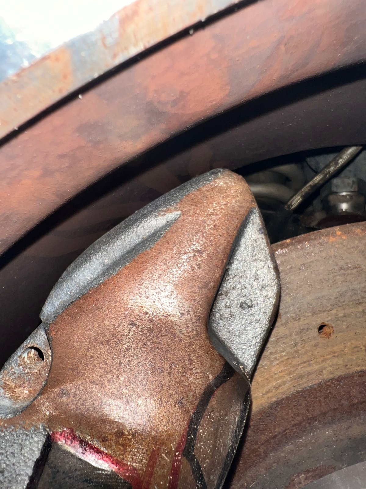

If that included brackets for the rear also that would be a good deal but that costs more than the brackets to use the C6 ZR1 Brembo calipers from the other company. The ZR1 calipers work with the 16" rotor so that would be a MUCH better setup than the Z06 calipers. Other than for looks, these truck really don't need bigger rear brakes. I just bought a set of the Powerstop powder coated red stock calipers for mine which matched the GM Brembo kit pretty well color wise.
I agree. ZR1 Brembo is better.
Do you paint the backside of the pad red?
To make it look homogenous? I'm gonna do that.

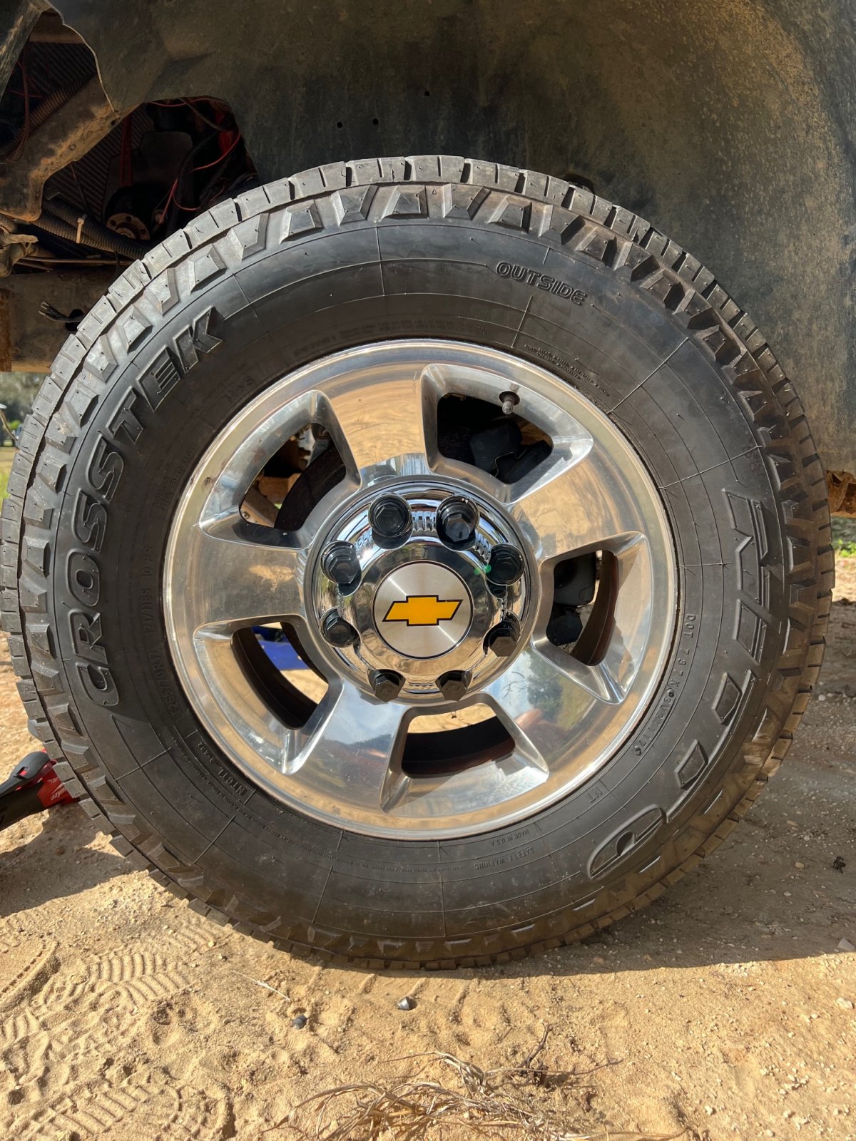

I just have a budget theme on my tahoe, so I'm happy to stay OEM when I can. There's a big difference between $600 and $2500.
I'm still kinda kicking my self that I bought the fuel wheels when I should've bought the Ebay AT4 squigglies.
