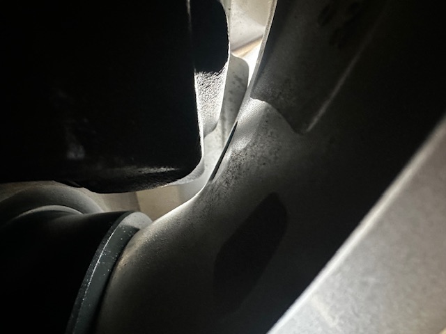

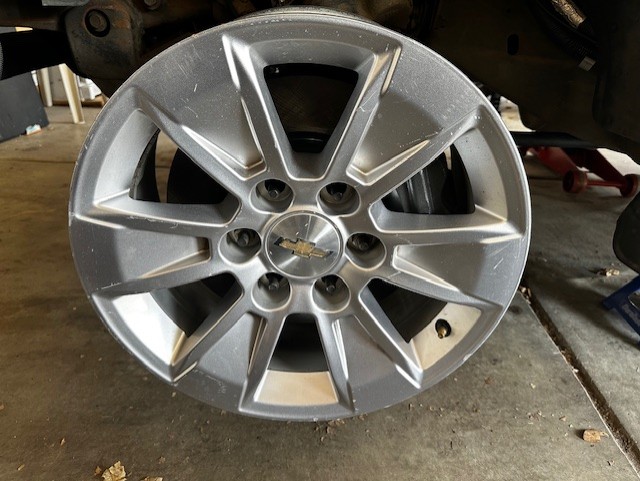

I'm getting this mod completed next weekend, but did a dry fit this weekend. I'll be using these 17" wheels from the 2020+ Silverado and they clear perfectly, as I figured they would.
