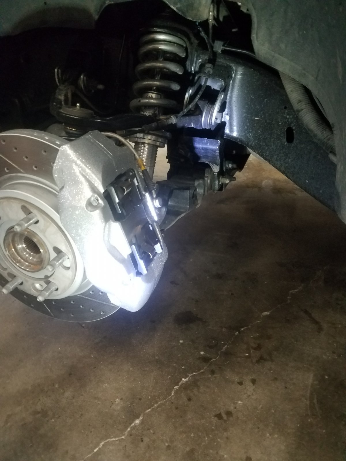

Sorry I thought maybe you got lost, legit my phone does this endless scroll thing and I miss stuff in threads.
Anyway i guess I dint know what else I'd take a pic of, the calipers look sexy but they really only look cool from the face. The mounting and all is the same and the spacing with the washers is pretty self explanatory.
I did take them apart again to inspect the pads and rotors which look fantastic. It's very important to do a proper break in and get everything embedded together. Red loctite is a biotch to break free when it's only a week old lol.
I agree with the non linear thing. They do feel better and better the harder you push. I'm glad they aren't crazy sensitive though. I will say it's almost difficult to bring myself to fully apply the brake knowing how violent they stop. On one of my test passes I had my laptop hooked up in the passenger seat and it ended up nearly behind the AC stuff under the dash. Thank God it didn't break again.
Here's the only other picture I have that I haven't posted.
