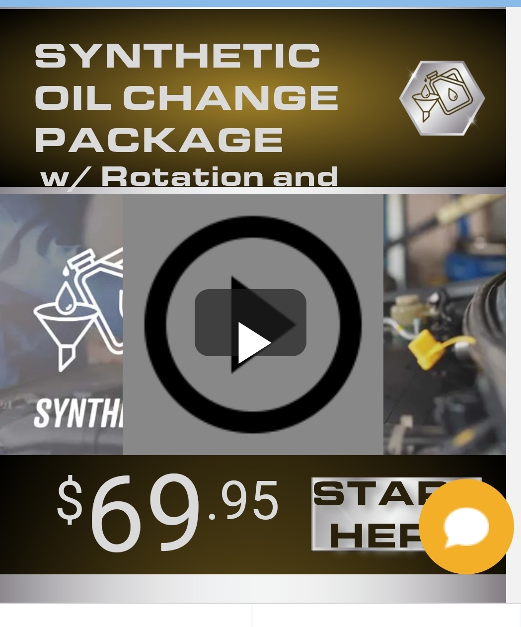

Check on the dealer's website for coupons also your local chevrolet dealer. 6 quarts of synthetic with tire rotation runs for 70$ here
