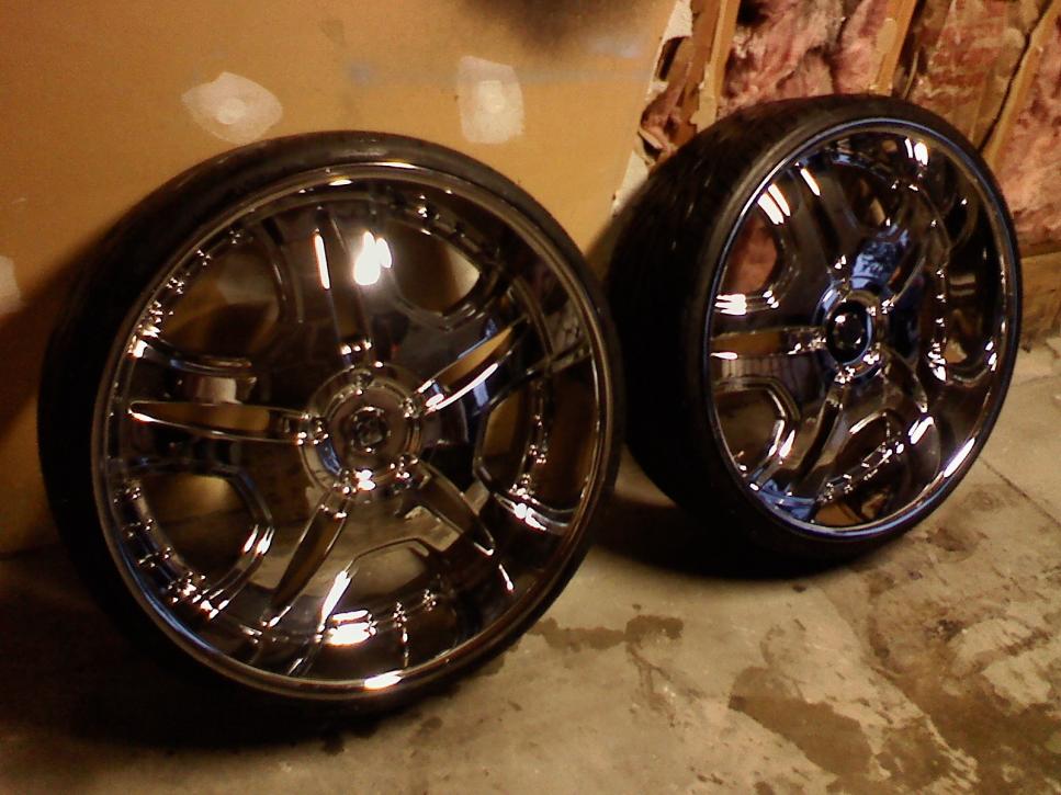

well my 28" rims are tis model 03 they are 28x10 with a 0 offest and 5.5" rear spacing, the thing im worried about is with the wheel being so heavy im scared the adapters will break or end up loosening the lugs and i will loose a wheel and im putting candy paint on it and the last thing i want is a 3000$ rim flying off and smashing my trunk especially becasue the rims are discontinued now also

Man one of my next projects is gonna be a short bed old body 2 door with 28s or 30s.. i cant wait..
Yea The adapters can be , not a bad thing, I wouldnt worry so much about them breaking .. the back of every dually on the planet is basically a set of wheels mounted to an adapter..
And all the dudes running SEMI wheels on trucks.. are running adapters...
Pro Stock Trophy trucks.... the dudes doing 150mph across sand dunes and rocks..
as well as most people running a tractor wheel on mud trucks..
and im sure ALL of those are going to be used more roughly than your 28s..
I cant answer your question about the hub change.. and if its as easy as you hope.. id dive all over it..
But if not.. dont let it discourage you because running adapters is NOT as bad as some say...
Im pretty sure.. you could actually get moser to just fill and re drill your front hubs too.. so there is another way..
