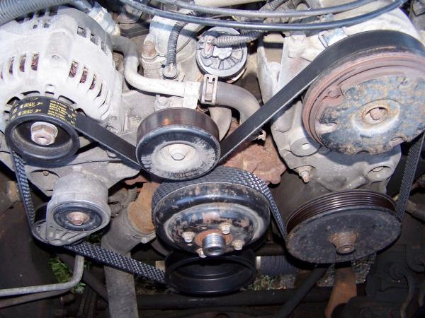

New belt, new idle pulley, new tensioner, new water pump, new alternator, cleaned pullies and still screeches when i rev up, at idle it doesnt. Im stumped, I need help. Im low on cash and don't want to spend anymore. Ac compressor is a possibility but i power it on and no change in noise as if if it was the problem. I bought a month ago and didnt do this until a few days ago but did it before i bought all the parts above, except for the belt. Please help guys.

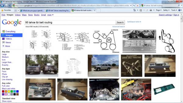

Its a new belt and did the soap thing and made no difference, it only quiets down when i spray it with conditioner on the groove side. Anyone have a pic of the proper position the of the tensioner on a 95? tensioner looks a little low to me but thats the proper belt for that application for an 105 amp alt any other belt is longer.

There is a sticker under the hood that should show the proper routing ... do you have AC??

I dont think it is the tensioner it was making that noise with the old tensioner. I notice the belt rides back and forward a bit but noise doesnt seem to be coming from there. I spray conditioner on the grooves and it quiets down. Im stomped guys.:emotions122::shocked:
