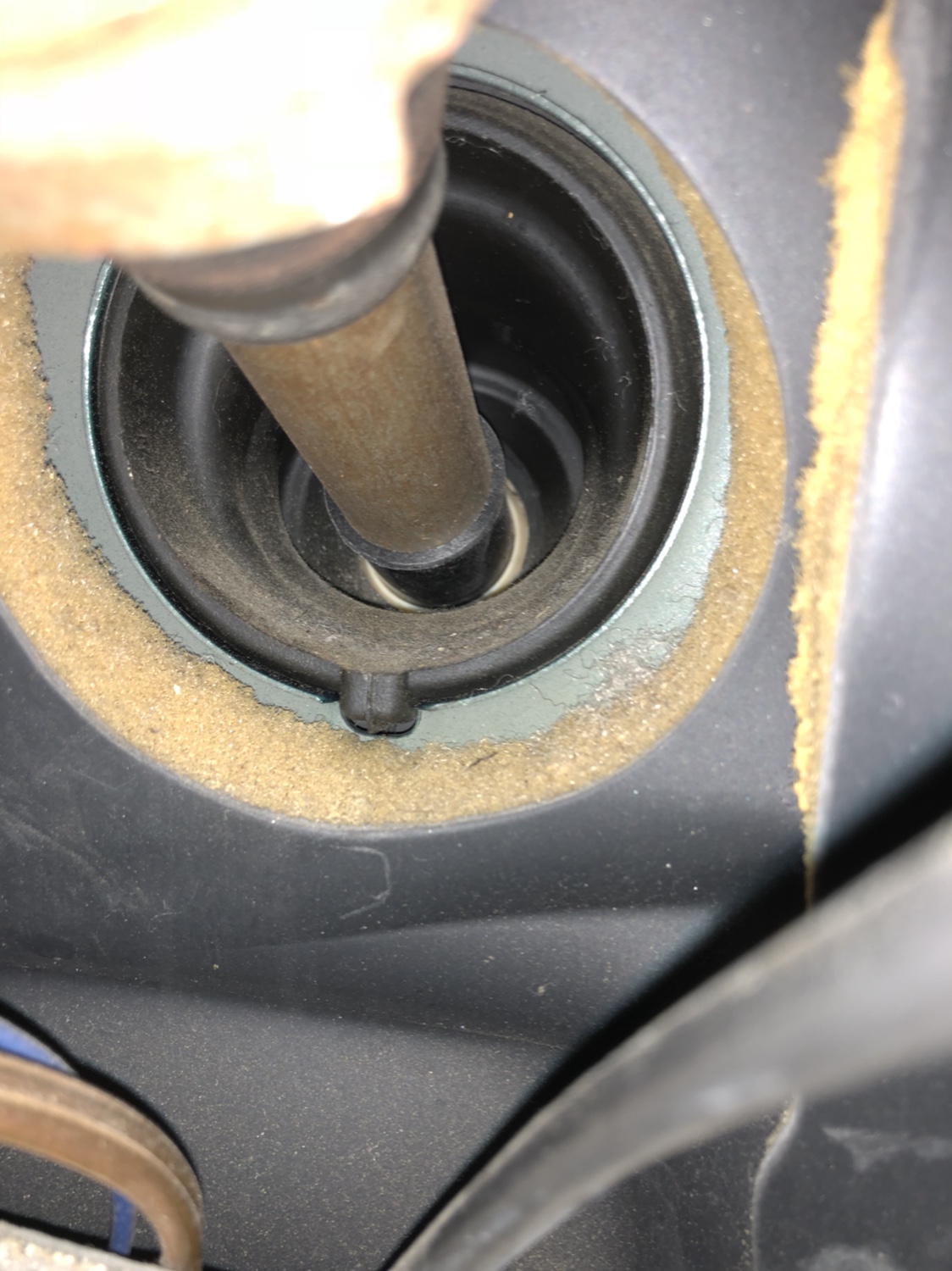

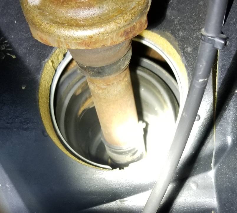

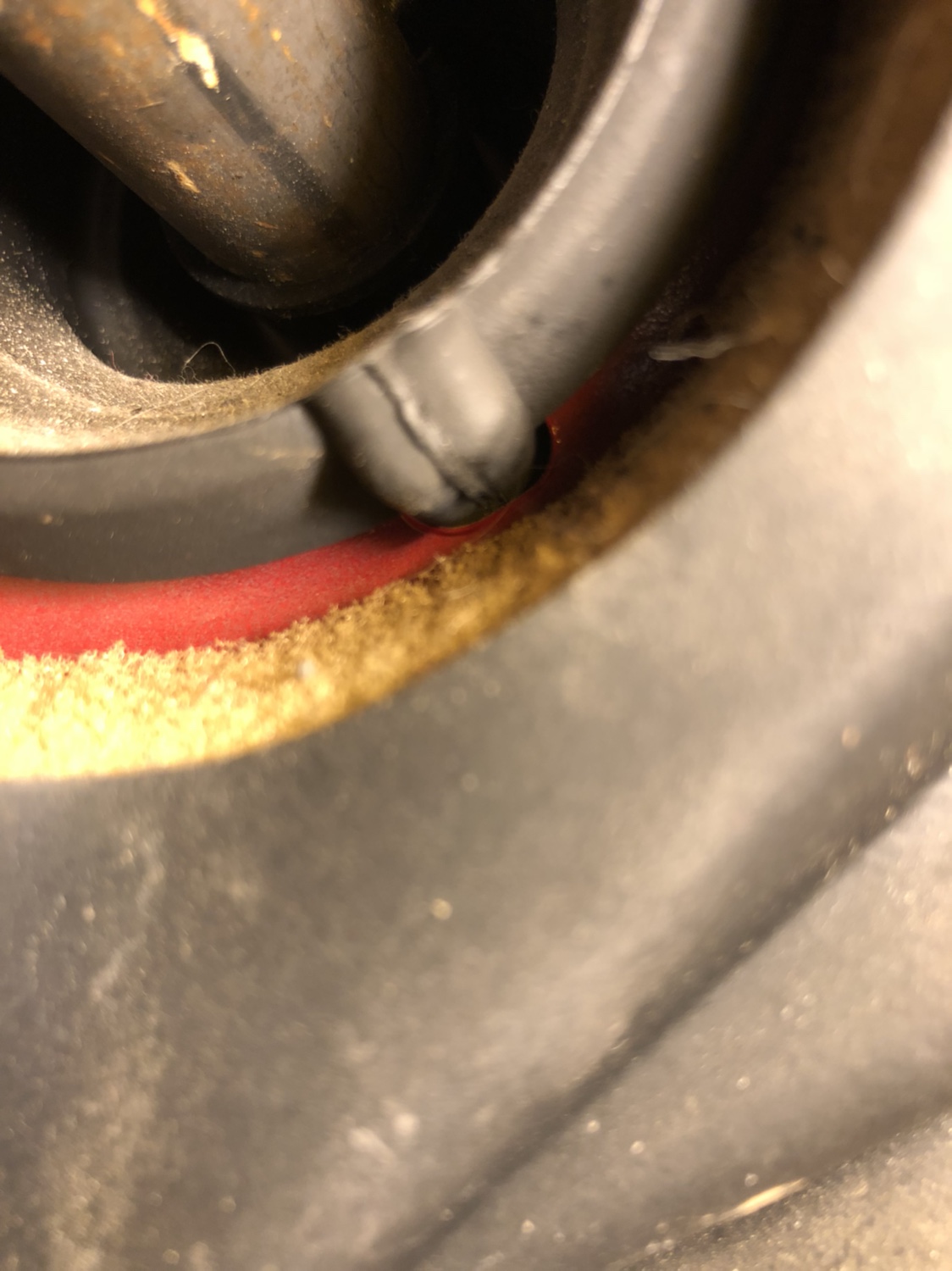

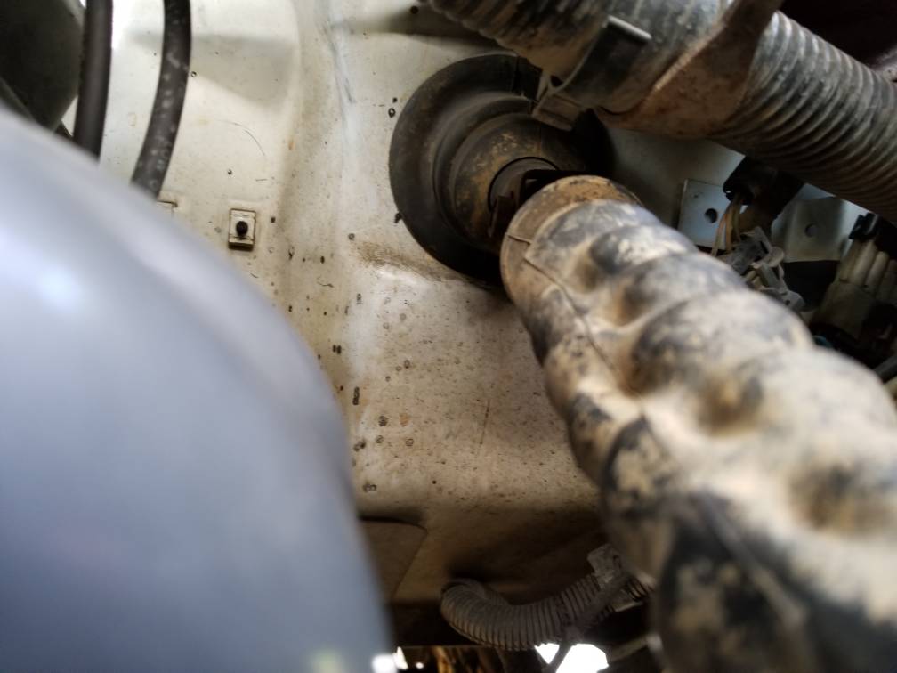

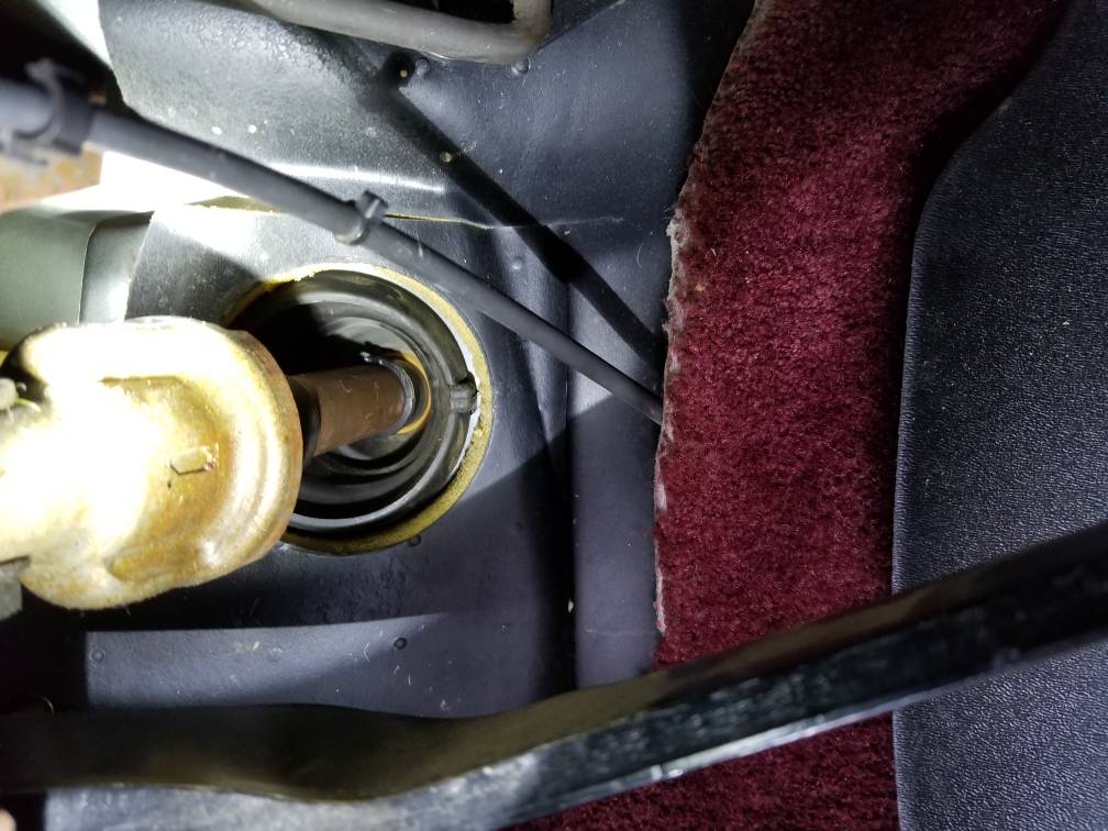

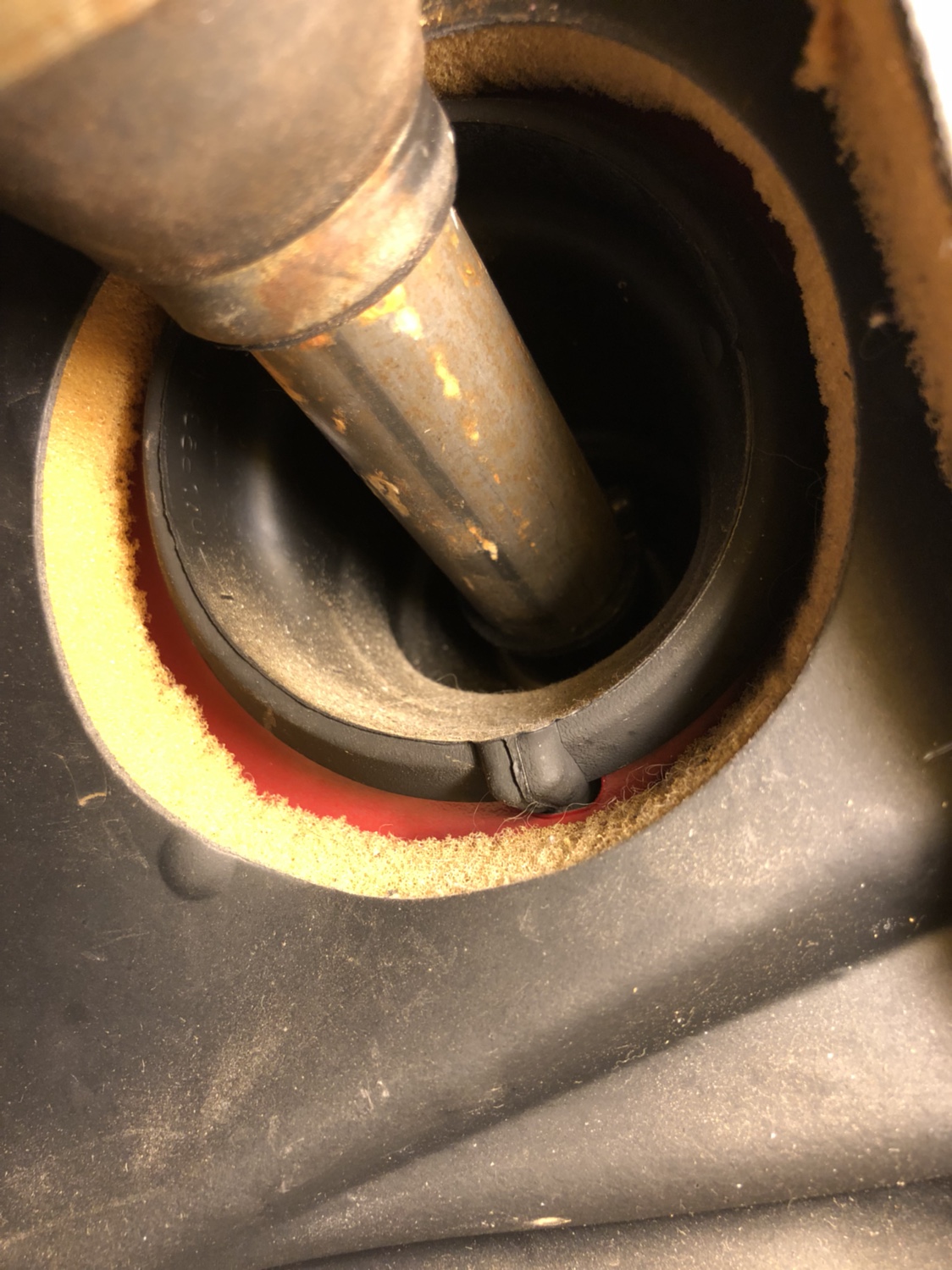

Is it possible that warm air is entering around the steering column enters through the firewall? It definitely feels like that's the area the warm air is coming from. When I put my hand down there, the whole area was warm to the touch.
Sent from my SM-N950U using Tapatalk
east302
Dec 21, 2016
1,636
1,526
Mississippi
Could be, I’m pretty sure the steering column goes through a rubber boot on the engine side of the firewall. It could be damaged or something.
