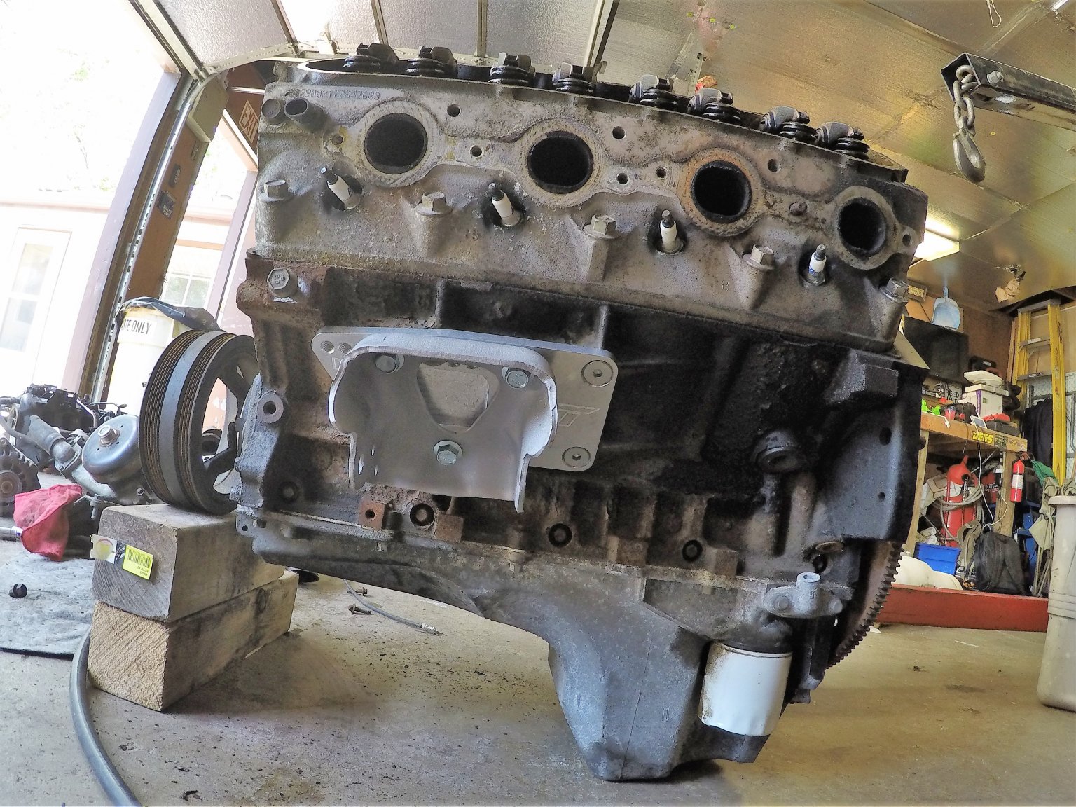

Also I installed the PCM tray. Are you guys tired of hearing about this PCM? I feel like I've typed PCM a million times now. Maybe I'm just tired. Enough, here's some pictures.
Scratch that shit off my list. Oh wait, I still need to make the top strap. Ok, I'm almost done with this. I could drive it this way so I'm still scratching it off my list.
