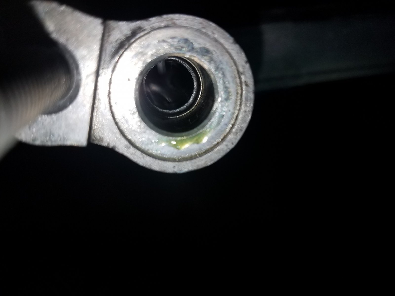

Here is 3 swabs of the line exiting the condenser. Also some pictures of the various ports. Everything looks really clean to me.
Even swabbed the compressor and found nothing but oil.

Should I blow the evaporator out with my compressor? I really don't want to put the dash apart.
Since everything looks clean does that mean it likely wasn't clogged and the compressor wasn't dying?
