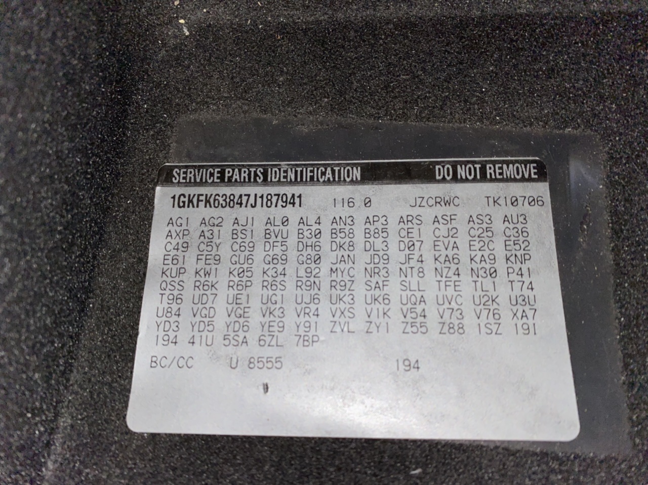

InTNallen
Dec 21, 2020
Oops...my mistake...double checked the RPO and I’ve got the L92. Ive got a ‘15 Yukon too and I get confused sometimes.
I don’t know where I read that I have AFM, but saw it somewhere. Oh well...I don’t want AFM, so no need to deactivate for me. Good news! Maybe I’m thinking of the ‘15 again. Haha!
Well..sorry to waste everyone’s time!
Where is this RPO sticker?
