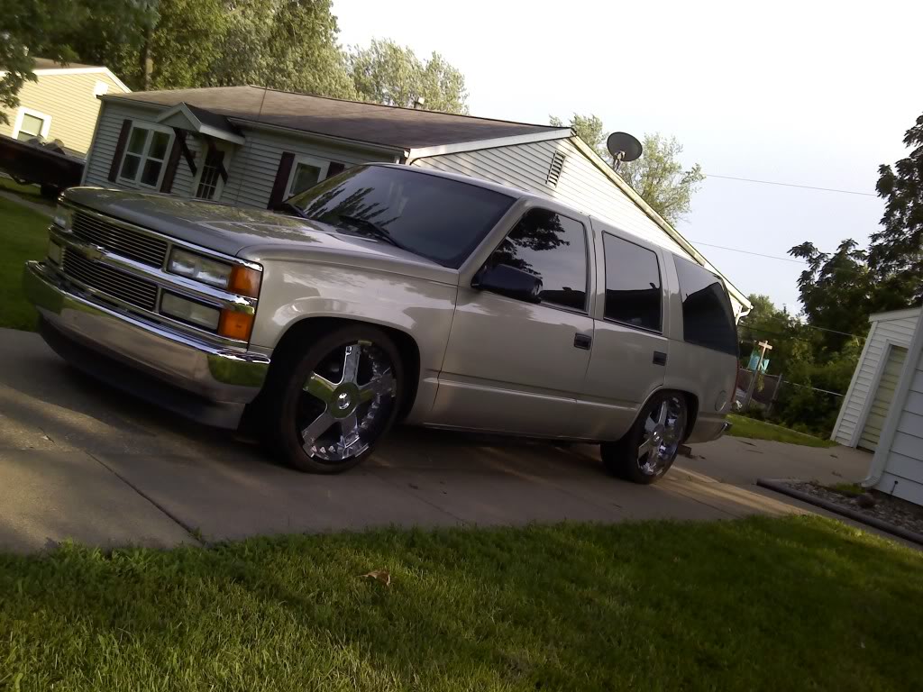

hey whats up guys i got my 2wd hoe about 1 month ago and the guy told me it was lowered 6in and it is very low..but my questions is i just put a set off 22's on it 2day and for some reason im rubbing in the right front corner on the fender pretty good...i measured all corners and got 28 1/4 on both rears and the right front but i got lil more 28 3/4 on the left front..im rubbing on the right front thinking spring but not for sure...it has bilstien shocks on all 4 corners flip kit and notch kit in the rear drop spindles and coils in the front not for sure stumping me can someone help out.....thinking about doing a 3-5 lowering kit so i shouldnt have any problems but would like to keep it lowered thanks for any input 0627001824d.jpg

Heat up the plastic on the inner fender and push. or just cut the part out
if it it the actual fender then get it rolled.

yes its lowered the guy said there was 2in lower spindles on it it is rubbing on the fender and they are already rolled and the rims are player 712's just missing the black feet on the edges and the BFH is coming next

Grnrpr68: Whats'up man, to answer your question, I have a 2" drop front and rear, but I believe the tahoe limiteds were lowered already from the factory about 1" to 1.5 so it's more like a 3-3.5 drop. (That is if what I read was correct). Either way, I rolled my fenders due to them cutting into my tires, and as far as the inner fender wells, ours are metal so you may have to beat them in or have them tubbed. My 24's rub the inner fender well on large bumps so I will be gettin my tubbed sometime in the near future. I's suggest, first rolling the fender lips and after that maybe beat in the INWs with a hammer or just have them tubbed. Hope that helps

mikeyboy thanks still gotta lot of work to do yet..........i spoke with tony at DJM and we might have figured it out..he is sayin that my drop spindles might have brought the tire out a lil bit 1/4 in and now on a bump dip i have a rub on the fender so hes looking into what i can do
