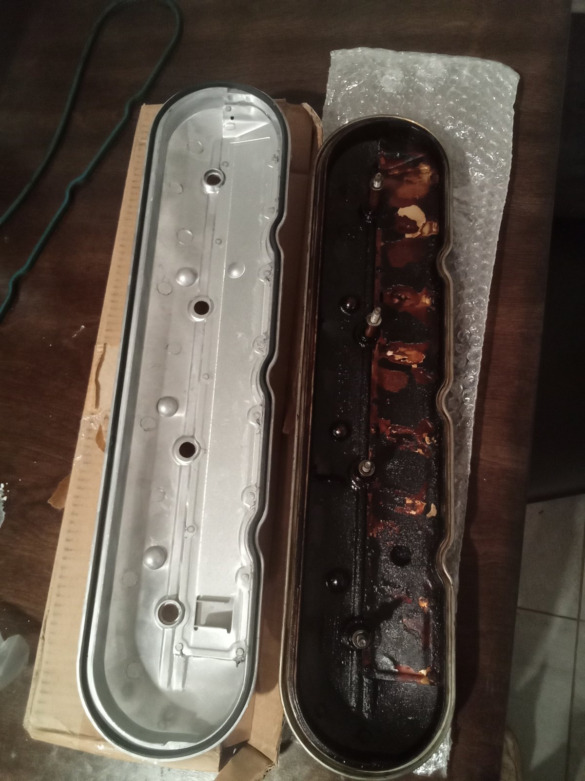

Received the new valve cover and gasket yesterday. I went ahead and changed the oil last night and installed the new valve cover.
Time to put some miles on the truck I'll report back.

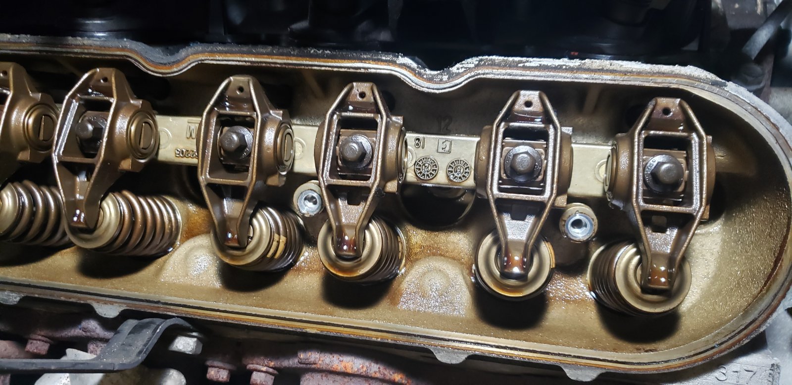

Judging from your old valve cover, you have a lot of engine blow by either past the rings or valve seals. Or simply a plugged PCV hose. Should look sort of golden inside. Below picture is an LS 6.0 at 120,000 miles, oil changes every 4,000 miles.
Had another set of heads on the shelf ready to go, and since I was pulling these off to change minor head gasket leak.... Put the other set of heads on with updated valve covers
