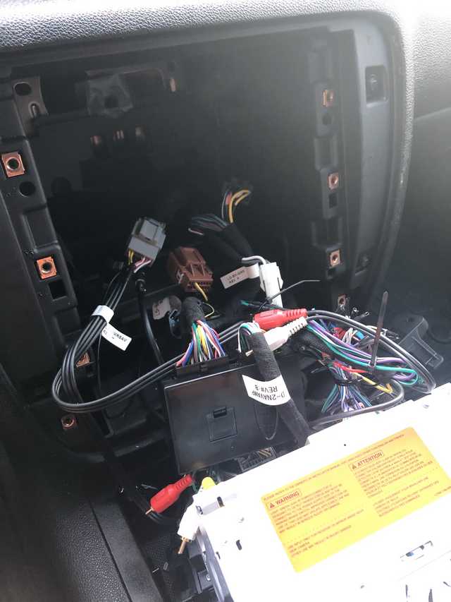

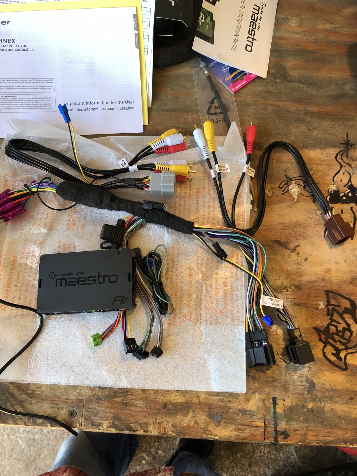

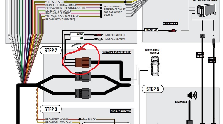

I recently added a pioneer 4200nex with a PAC rp5. The issue I'm having is that the factory head unit was the no screen model, meaning the back up camera goes to the mirror. The rp5 integration module came with a harness that connects the factory brown plug, camera/sub/center to the aftermarket head unit, but that brown plug wasn't begins the radio. Where can I find this plug, as I want my subwoofer back. I am extremely disappointed in the outcome and am considering going back to the factory head unit.
Meccanoble
Oct 3, 2016
1,166
355
Georgia
You need an additional PAC harness that retains the rear entertainment. But I dont remember the subwoofer being on this plug, it was just the red/yellow/white rca for rear? I bought same setup as you with rp5 gm31 and trying to remember the other harness but its listed on PAC site and instructions. But at the end, you get a yellow RCA that connects to the rear camera port on back of 4200 nex (brown rca port) and below that are the 2 RCA's for subwoofer. The connection for sub from car to PAC is only 1 RCA but the 4200 is ready to take 2 (red/white). I think even if my sub is unplugged, I still get the subwoofer working. Its only if I unplug the specific harness for sub that goes to bose amp that it stops working. Hope this helps.
