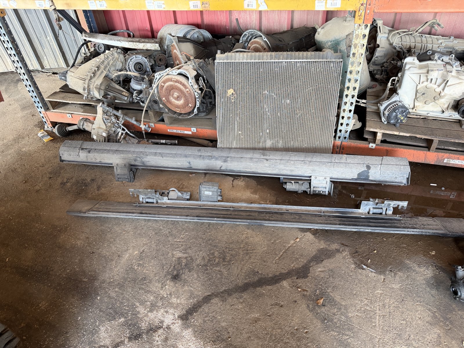

I think it would be clean like the one attached:

That is what I have been debating. The only thing that scares me is how much action these things get with foot traffic, rocks, road grime etc. I don't want to get them painted and then it get all chipped up and look like garbage! I love the look, this little clone of mine keeps me wanting more lol

gotta respect bagged's tenacity. nice.
i actually really like the look of these since it makes the car look even lower. they act like typical side skirts. if you're a modded ride, might as well further differentiate yourself in pleasing ways instead of doing a ton of work for... a factory look.
for my range rover, the factory side skirts are popular with the modded crowd for the very same reason stated above.
either way gl
