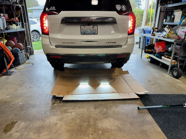

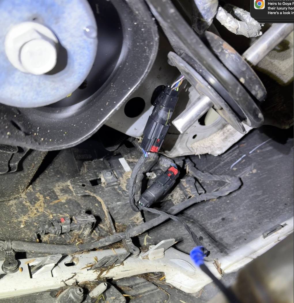

Alright ya’ll. Got it to work. Customs harness from GEN5DIY https://www.gen5diy.com/. Just let them know your Y/M/M and that you want a harness to have ground/reverse from rear tail lights. I choose to get a pair so each light is only drawing from each side. Figure with how electronic sensitive these cars are that would be the best option.

Connection points under the vehicle for each tail light.

Assembled Light's with harness
Each light working off each tail light with no errors or issues.
Have fun everyone. Now i get to spend time figuring out making mounts for my lights without drilling any holes in my bumper :)
