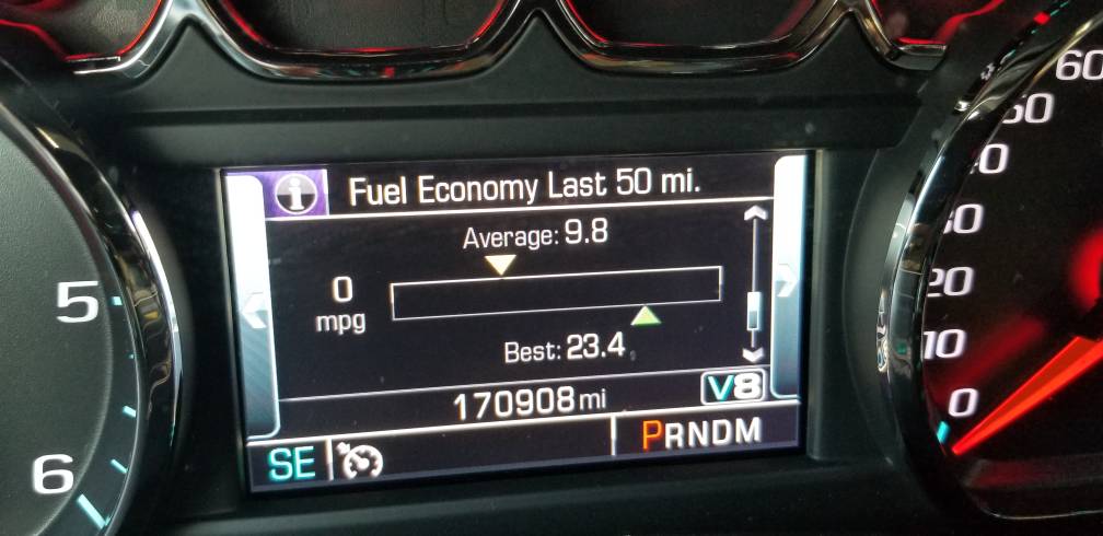

Btw, how do you know what the content of your e85 is?
I use a scan tool (Tech-2) to see it.
