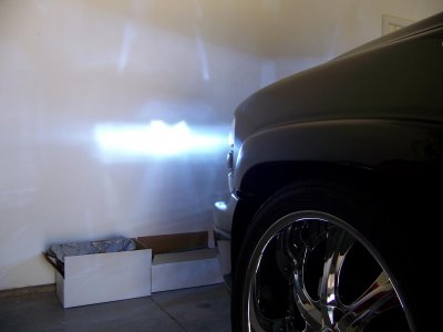

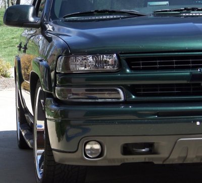

I had to take these apart and fix the adjusters to get them semi close. You can still see that I have the gap that you are talking about where the top light meets the grill. When my truck gets out of the shop (body mods) I will get them set perfect. Gotta love the HID's.
