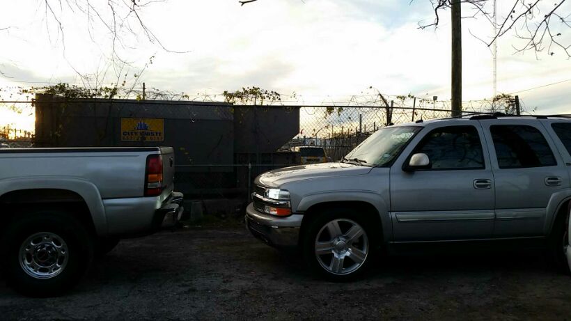

Just thought I should seek help here before I go to a mechanic.
Lately my 04 tahoe has been backfiring, in one instance, it felt like my engine was gonna stall, so I gave it a little gas and it did nothing but backfire and then the truck went forward. Happened again about a minute later while pulling into a parking garage. It's been happening on rare occasions but now it's becoming more frequent. The check engine light comes on sometimes but not all the time. Just wondering if anyone has been through this, I've heard it could be bad catalytic converters.
My tahoe has no mods other than a magnaflow bullet exhaust I installed about a year ago.
