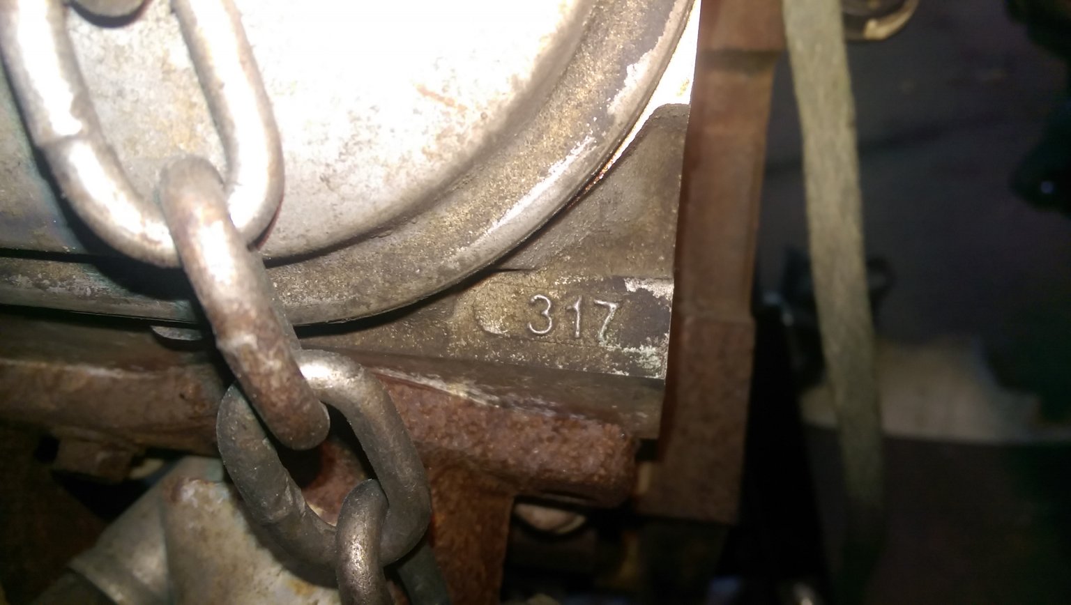

Does a 2004 Escalade with the 6.0 have aluminum heads?
What's the casting number?So would I need to worry about the castech heads with the LQ4 6.0 in my 2006 Denali xl? Still learning about this motor and I'm concerned about that problem with all I've read about it.
The only ones that I know of that had cast iron heads were the '99-00 6.0L.I dont believe any LS/LSX engine ever came factory with cast iron heads ever.
It's on the exterior of the head. Found this on the driver side above the exhaust manifold, close to the firewall.@SnowDrifter , not sure on the casting number as I haven't opened them up. @95escahoe , I thought the same on the 4.8 and 5.3 but I wasn't sure.
