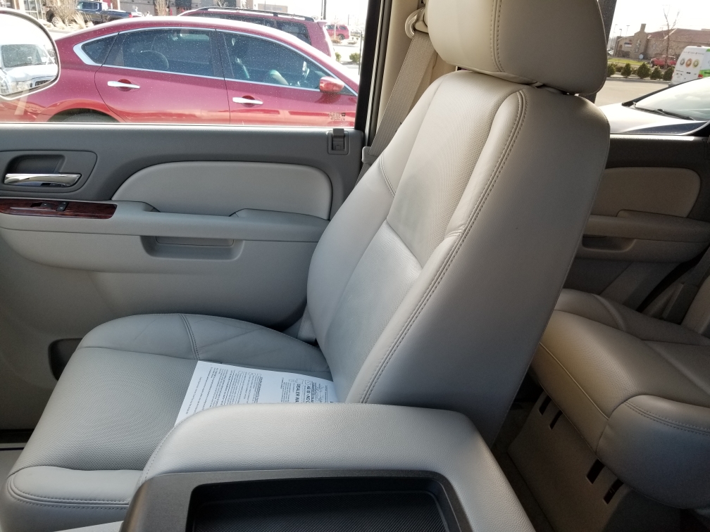

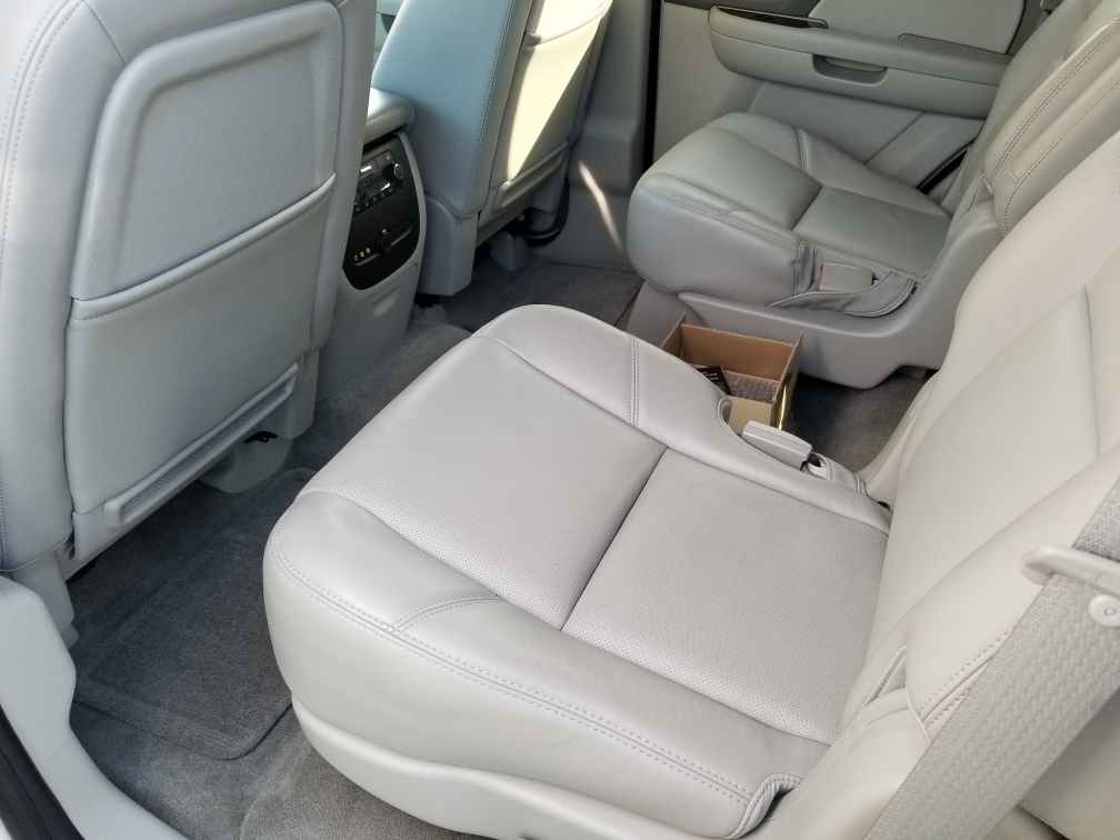

This is a solid point. This Yukon is indeed at a smaller dealership and not a large new car dealer.
They are sending you the additional pictures you're asking for so that's a good sign they're not trying to intentionally hide anything, but I would certainly not buy sight unseen. You should be able to tell if the truck was garage kept by looking at it. Look at the plastics and paint and it should be easy to tell.

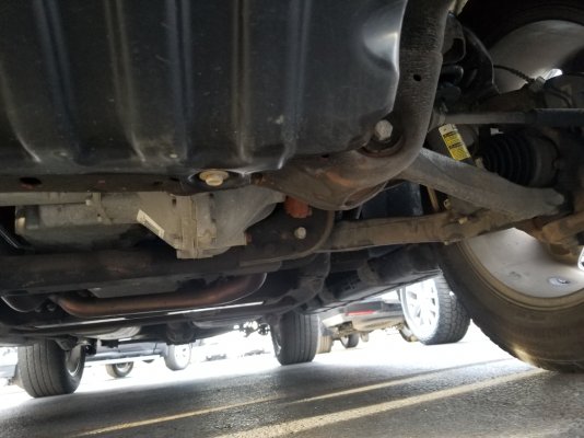

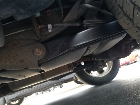

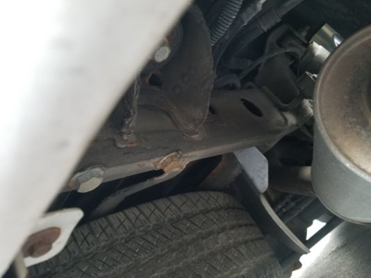

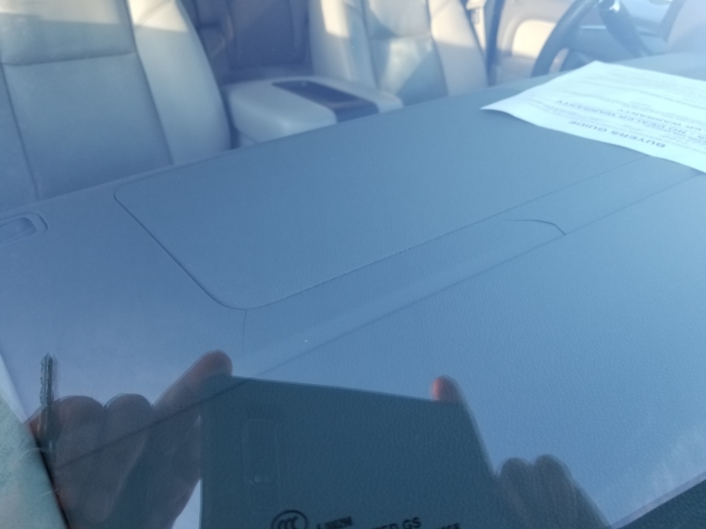

I'm staring hard at those pics and don't see the crack.... this is why I love this forum. Nothing gets by you guys!
they are all cracked with VERY few exceptions, nothing to worry about it's one of the very few defaults with this generation
