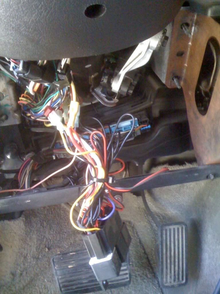

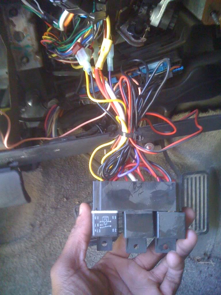

do you guys have any photos of the wiring job you did??
I can turn a wrench, but unfortunately not very good and figuring out the electrics unless someone shows me :Wedgie:

hey rigo - where do you splice the new fuse/switch in? (i'm a newbie with electronics)
Also, if i simply pull the fuse on the crank, is there a way someone could hot wire my hoe? (for a temporary solution)
if they know theres a big chance they can start it. because they would know whats the kill switch for, and where to find it. but if you keep it to yourself they wouldn't know where to start. by removing the fuse the truck will not be able to crank even with you key in. so even if they brake your ignition switch and tried manually cranking it by touching the wires together the truck would not turn over. the only way to start the truck would be to push start or hot wire the starter when the ignition is on. but if they cant in the first try, thief will leave it and go look for something easier to get.
thats why i had so many hidden switches in my hondas.
i trust more the fuel pump fuse but thats located under the hood. i will try to get some pics of how to find the wire asap you're asking for.

Anyone know where a good place on line would be to get those fuse holders? The three stores we have that would have that dont.
Or would it just be as easy to splice into the harness? Is it hard to get to?
