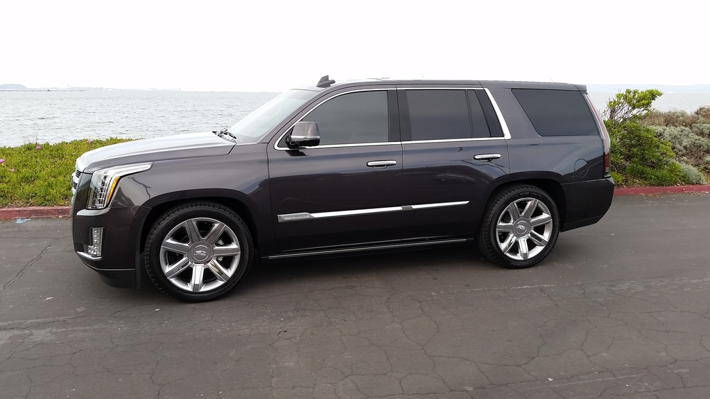

hers the thing they sit way high in rear. Once you get the truck i can do a 1/1.5/2 drop kit in front with the struts and rear 3.5/4.5 with the belltech kit. Bumpstop brackets will need to be cut depending on how low you go.
here is 2 front/4.5 rear
I've had the Tahoe for a few months now. I'd probably be happy with a 2 in front and 3.4 in the rear. Is the belltech kit available now? I just want a good ride after the drop, so it the spindles are better I will probably wait. I have a mechanic friend who helps me with these drops. We did the 2010 tahoe I had with no issues. I guess cutting the bumpstops would be the only thing we didnt; do with my last one.
Those are 22's in the pic right?
Also, Are there any Rubbing issues on the front with 24's. I know I had to heat up the inner fender wall and bend it in on the 2010 so it wouldn't rub.
Thanks!

Rides fine on drop struts in front. If you want to wait for spindles no prob.
Rubbing on 24s with my fenderwell mod.... you will be fine

4x4 spindles will come with upper a arms so will be in 600 plus range for the kit.
I have yet to have a person complain about the drop struts at full 2 inch drop will need camber kit in front
