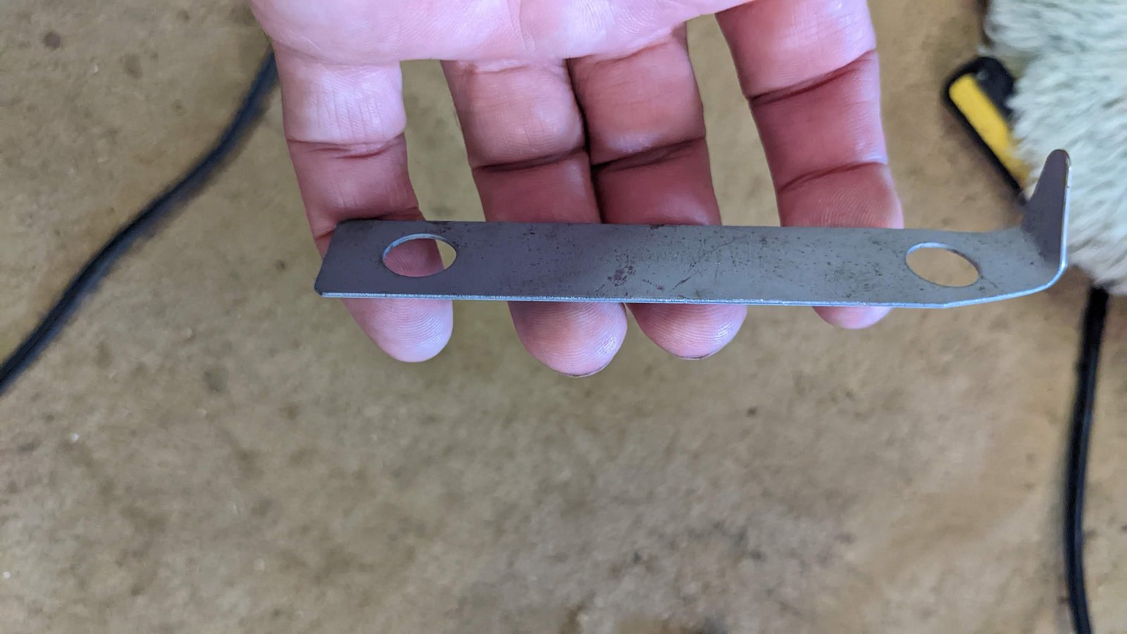

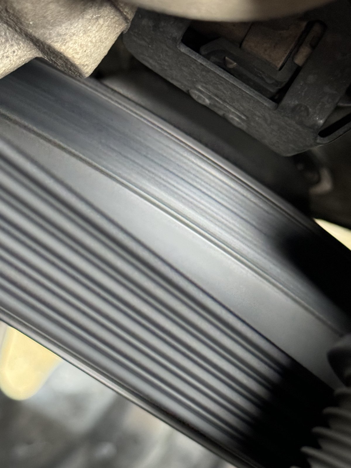

after a good 6 months of trying things, including a Lazer belt alignment tool made by gates, I didn't get it. I got a go pro video of it. a kinda non car guy friend of mine saw the video, commented the belt wasn't centers on the crank pulley. I'm like sure it is, what are you looking at?
long story short, I got to looking and he was right. damn compressor wasn't aligned right. there's no adjustments, it just bolts to the block and over 100k miles of hard use never a issue. but once it did it, it kept doing it. I could toss it on demand. 2 new oem tensioners, different belts, nothing. in the end a old school starter shim put under both rear bolts, belt centered up on the crank pulley and never threw it again.
I got nothing.. my only theory is core shift in the block.
I honestly didn't see it at first, it was towards the front of the pulley in this Pic. once shimmer up it ran even on both sides and never have had a issue since. beat the crap out of it trying.

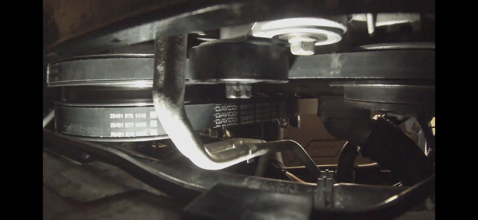

here's it rolling off.

I actually had thought about asking around to see if anyone I know has a GoPro I could borrow to see what’s going on. I do see in your video it looks like the belt is pushed toward the front of the balancer. The AC compressor bolts to a bracket in the trucks, it could be possible there’s just enough movement in the bracket to the block and in the compressor to the bracket that it could be misaligned, or maybe the bracket could bend a little with age. I don’t think the C6 has a bracket though, but it’s been a while since I’ve done a compressor on a C6. I was thinking about trying those gates green HD belts but that may not doing anything.
In a similar vein, I used old-school suspension shims to align the brackets/pulleys on an aftermarket serpentine system the previous owner had installed on the 401 in my '79 AMC Spirit. You can get sets on Amazon for under $15 and there will likely be more than enough 1/64", 1/32", etc. to take care of any/all brackets on an engine.
