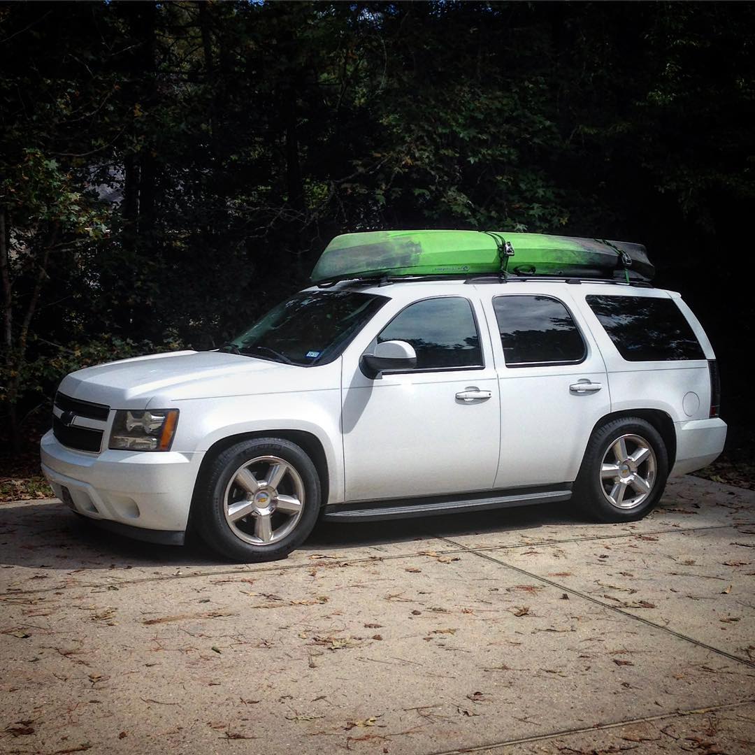

You can lower and keep the auto level air ride functional. Just depends on how low you want to go. My Burb is 4/6 and my auto leveling still works. I just used shorter air shocks out back and resistors to keep lights off on dash.
Also on factory 20's...
