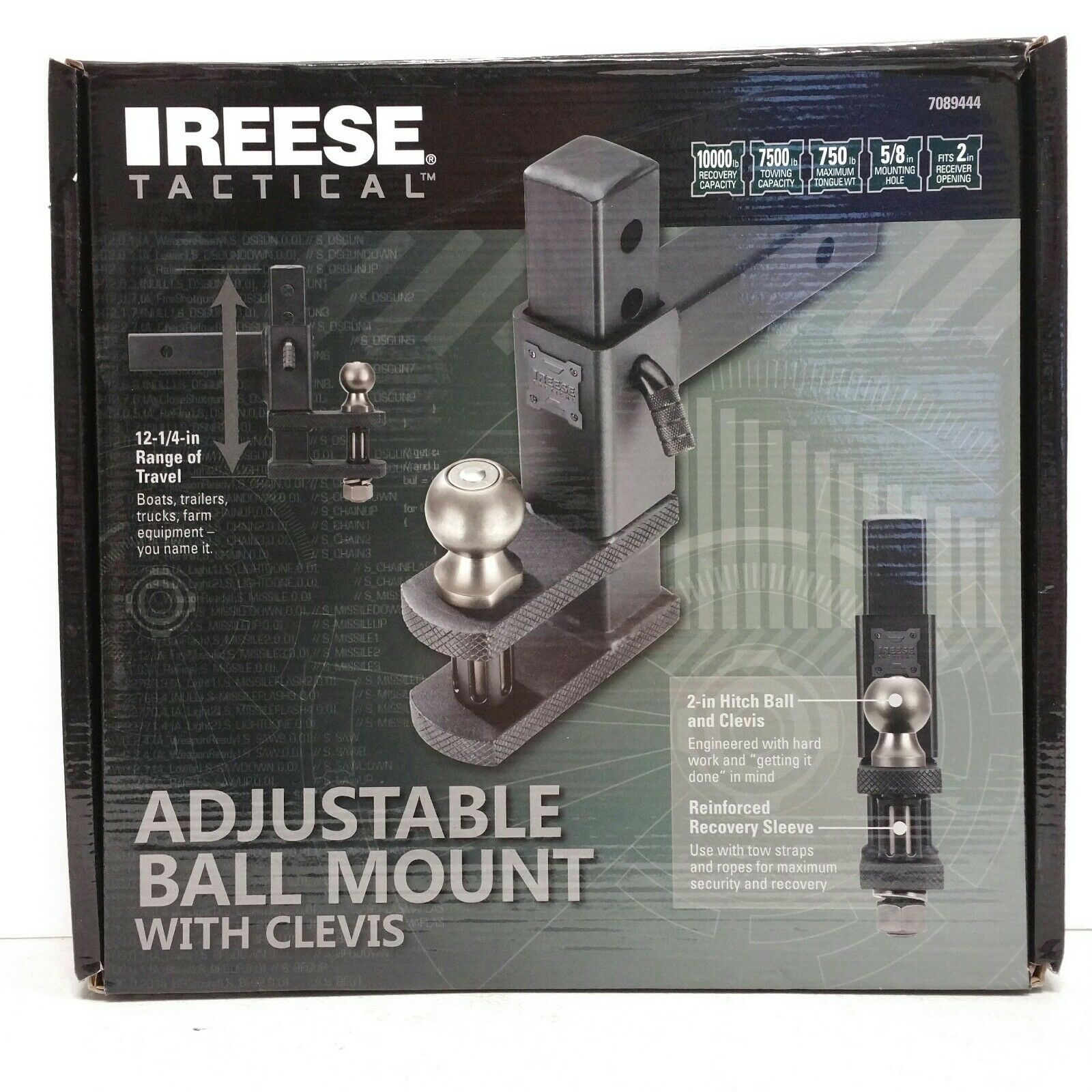

Six to eight inch drop. I used a fixed 5.5" drop first time around (in stock at Walmart) but trailer was not level even after being loaded. Then I bought this with both balls and it's been great:
https://www.amazon.com/Reese-Towpower-7089444-Tactical-Adjustable/dp/B079Y4Y5WR
Paid only $45 at Tractor Supply last year, Bass Pro Shops carries the Reese Tactical line too. They've become mighty proud of them it seems! I like the clevis and have already made use of that several times with the tow strap.
#7089400 - (includes 2" Ball 7090000)
#7090100 - 2-5/16" ball
#7090200 - 5/8 Hitch Pin Clip (only comes with 1)
I don't leave it on so no lock, dog bone locks that match are $20 at Bass Pro Shops. Note, those balls have a 1 inch thick, six inch long shank for the clevis, very tough.
Wow, that much of a drop!
What makes this 'tactical'? The subdued finish or the checkered edge surfaces.... Lol
As much as I like Bass Pro, I find their prices higher than other places, like Cabelas. That may have changed recently since Bass Pro ownes Cabelas now.
Both!
Think about it, our hitch is part of the frame and bumper unlike your older truck, bringing it up several inches. The bottom of my truck's receiver is 22-23 inches and most trailers have a coupler/hitch height of 14 to 18 inches.
