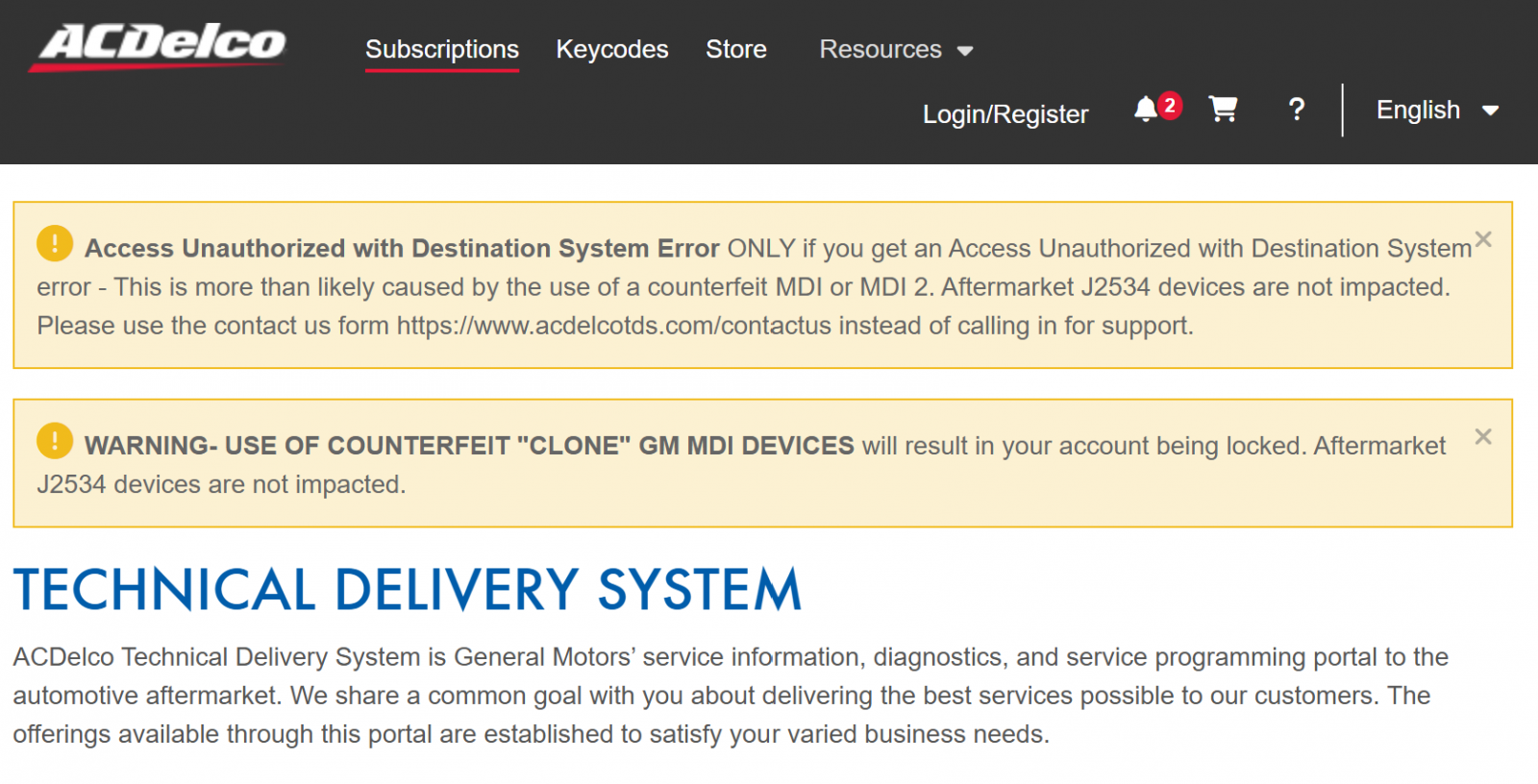

Logged into the ACDelco TDS site in anticipation of probably needing to program a new power window switch that's on it's way, and they very prominently warn against using clone tools at the top of their page.
So now I'm worried about even trying... not sure how they could tell if I do or not.
Anyone try to use one of their knockoff tools lately?

if you plug in the mdi and it is able to update with the bosch software then you are probably ok, you need to do that 1st anyway otherwise it won't work period.
the message above is what you "could" run into, if you get the message then stop at that point, then if need be grab a 3rd party device instead.
I used my clone mdi 2-3 months ago and had no problems

also you gotta kinda wonder how many people are out there working under the assumption that there mdi is a genuine one and it's not? there has to be some leeway in there as far getting your account locked, one would assume it's not a automatic thing

I did in November. Saw the same messages.
I think I updated the software off of Bosch's website first, before logging on.
Some time back, I was under the mistaken impression that I had bought an MDI2. What I received was an MDI in MDI2 clothes.
There's a video on Youtube from 11 months ago of a guy using the Tech-2 again to program modules.
