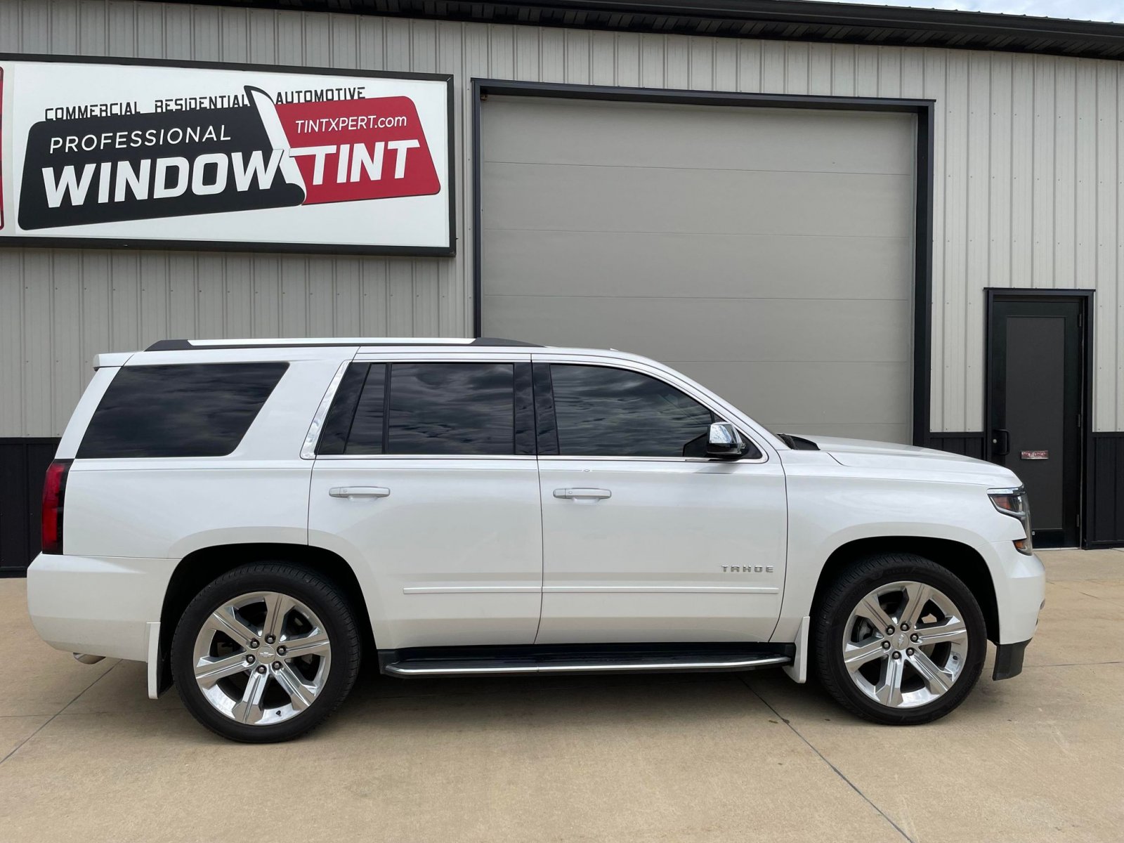

djamac
Sep 9, 2019
Went out tonight, so I took another photo. If you pardon this idiot’s shadow, I think you can clearly see that there is a noticeable difference in wheelwell gap between front and rear.
Looks good, I hate taking pictures, the only reason I have one, is the window tint company took it.
