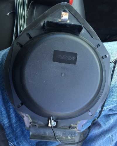

I used the factory speaker and mounting bracket so I did not have to buy an aftermarket bracket for the speakers. Pretty easy, just break off the speaker cone and then the plastic bracing on the rear that connect to the speaker magnet and pretty much good to go. My door speakers were just right diameter for the bracket to I did not have to break off the lip you see in this picture, some speakers you may have to. I was able to do this with all four door speakers.
Added the metra speaker covers on the rear of the bracket for protection and added sound quality. Not sure if they made a difference in sound quality, only saying this bc other have said they help with directing the sound towards the inside of the truck and not the inside of the door. I was mostly concerned about the water and dirt that gets inside the door, so should help for that.

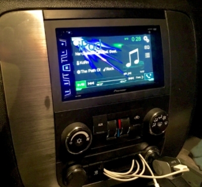

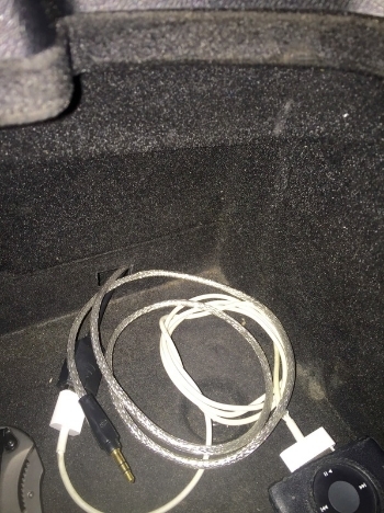

Pioneer AVH-270BT, hands free Bluetooth, DVD/MP3, Ipod, Aux Cord, 3 amp outputs, rear view camera input, 1 monitor output. Pretty much everything I was needing, and for 200 bones I was pretty happy with it. Only con so far is it sometime will have some lag and will restart on its own but otherwise its a small issues nothing real concerning. Will eventually get a more high end double din with NAV and all the goodies like this one plus more functions better settings. Working on getting the wiring and mounting spots for the USB/AUX cords in the center console right now only have a hole and cords sitting in the console. Also will be getting the back up camera eventually. Will post up dates when done.

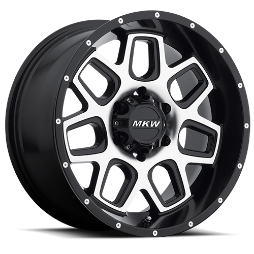

Ordered these last night with black lugs and my TPMS since my truck came with out them. Now I can get rid of that pesky TPMS light on the dash.
These are the MKW M92 series, 20"x9" 6x139.7 -10 offset.
I have done some searches and made some posts on how the -10 offset will sit on our trucks and no response yet, hopefully soon I can get an idea. I can always return within 30 days so once I get them in and test fit one before I start mounting them ill get my answer for the most part. Should be in a within a week or so. Will be sticking with my factory tires 265/55/20s if I remember correctly, they are in great shape and hopefully wont look too off the wall but if so o well, we will see. Will post updates eventually.

That rim being 9" wide and -10offset they should stick out about 1inch... Your stock tires should be 275/55/20... With that offset your prolly not going to be able to go bigger without cutting due to rubbing.

Thanks for the reply, and thanks for the correction on tire size. I'm fine with the trimming when needed. The most I will be doing is a leveling kit up front and maybe a 1/4" or 1" spacer in the rear. Eventually I would like to go with 33s and that will most likely be the biggest I will ever go. Not sure if I will be doing the 33s in the near future or not.
I was a little unsure after doing some research and reading some miss leading info here and there that I was getting a bit confused with the whole offset of +/- with regards to the +35 off set of the factory wheels. I have been trying to find a good photo of someone that stated they have either -10 or -12 offset so I could get a good idea of what I would be looking at.

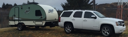

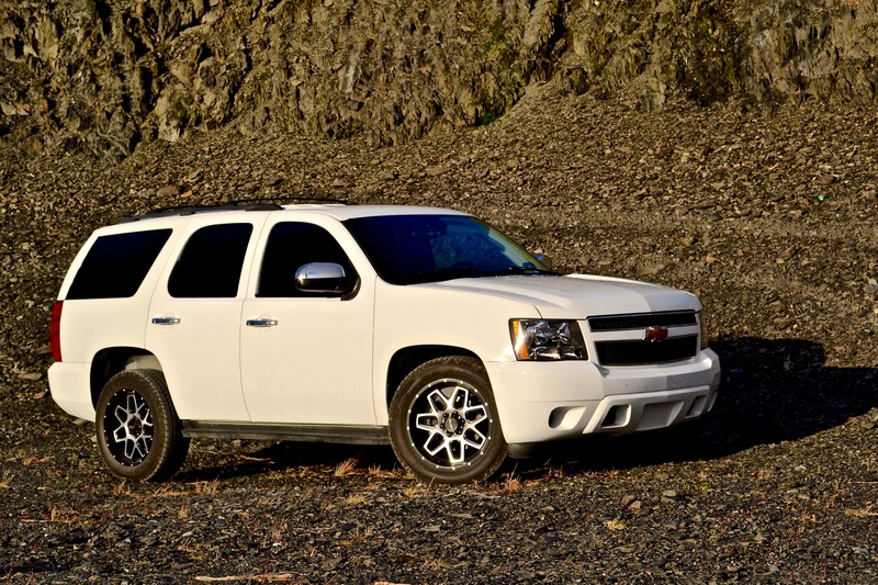

Here is a picture of how the Tahoe sits with a 179 RPod 20' trailer. Rides pretty good for worn out stock suspension. I do need to get some heavier duty shocks for sure though.

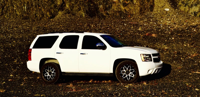

Look what was at my door today when I got home. Just waiting on lugs and TPMS to get here and hopefully this weekend I can get these bad boys on the hoe!

Got my nuts I mean lug nuts in today. Also ordered my hub centric rings today. Im gunna roll for a few days while I wait for them to get in. If I can get a couple hours away from home tomorrow ill get these wheels mounted up and installed, If not tomorrow then for sure Sunday.
