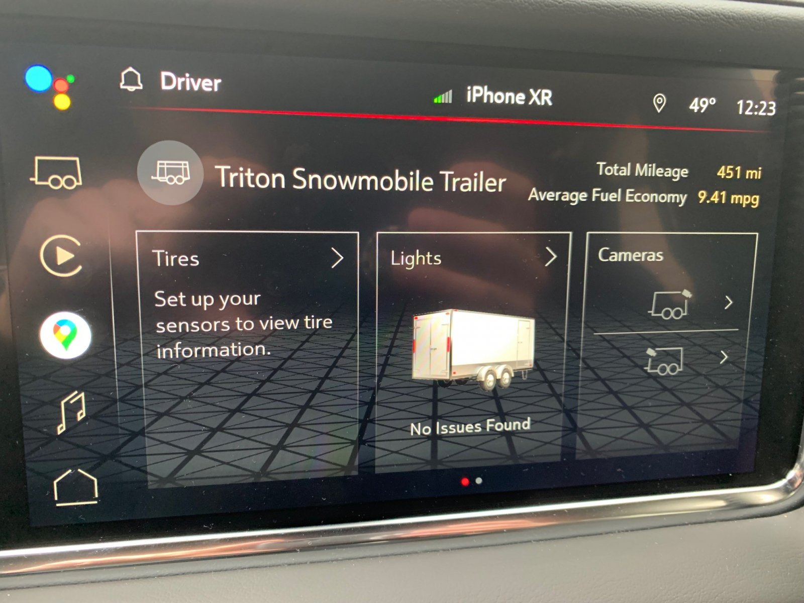

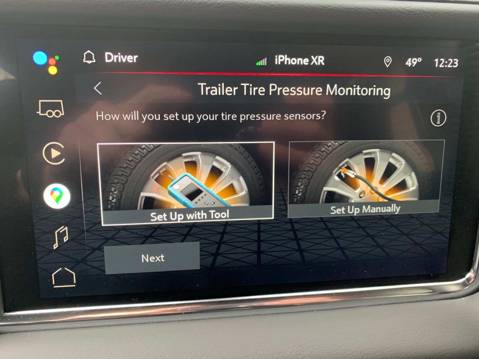

Checking back in -- any of you 2022 owners w/ Max Trailering Package towed anything yet? Did the Trailering App prompt if you wanted to set up tire pressure sensors?
My goal: Confirm that even without ordering the Tire Pressure Sensors from factory, that the truck is capable of having them programmed (I will then order some to be installed in my boat trailer tires).

Yes, I got my 22 Yukon SLT 10 days ago with Max Tow, took my trailer tires to the tire shop with the sensors that were purchased at the dealer (not ordered with the Yukon) had them installed, put them back on the trailer, went into the trailer app in the infotainment screen, followed the instructions and started the learning process (manual) let air out of tire one and the Yukon honked twice, went to the second tire let air out and again the Yukon honked twice and was done, worked perfect.

I actually had my wife sit in the Yukon watching the screen as some have commented that theirs never honked just the green check mark appeared on the screen for a particular tire that was learned but mine did the green check mark and also honked as it should.
You also need to have the trailers "umbilical cord" connected.
