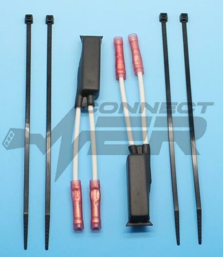

Ah, so their special addition is this:
Arnott's new exclusive design includes a sensor which plugs into the auto-damping system to eliminate dash panel error messages.
They have added a built in resistor. Shrug. Not worth it to me over much less expensive bilsteins at all, espcially since you don't really know what shock you are getting. If you are deleting you just unplug the sensor on the shock and tuck it out of the way, disconnect the battery, pull the relay for the autoride, and reconnect the battery and the truck will have no error messages. I've been running mine that way for over a year with no errors.
