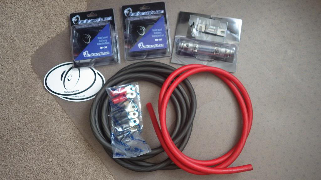

I'm jazzed I could finally order my Big 3 upgrade cables today. Knu had been out of stock on the cables for a bit, but now, I've got my order in!
Time to gather the rest of the supplies to do my Big 3 upgrade. Likely after Thanksgiving at this point - need to get my Christmas lights (or holiday lights for you PC types) up on the house this weekend.
