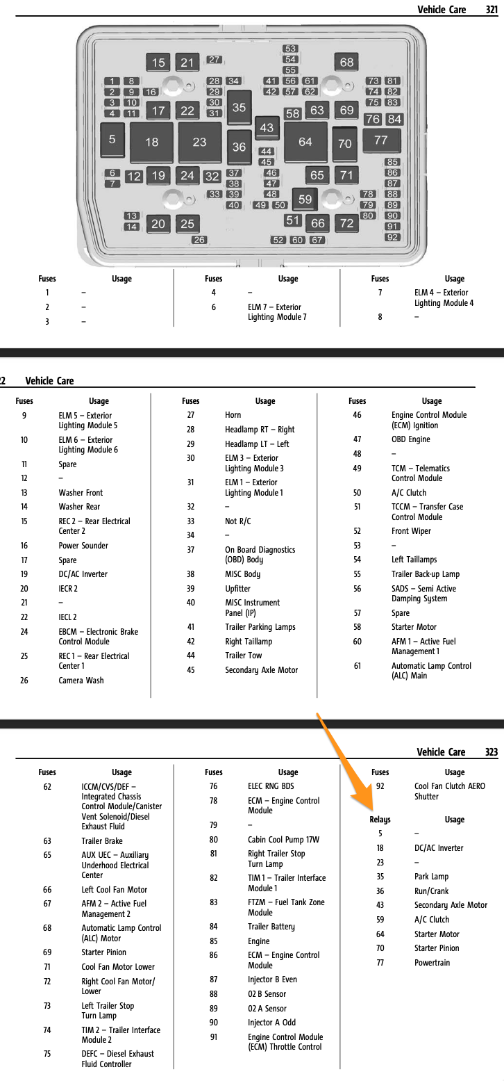

This may be the stupid question of the day, but on the 2021 Yukon, how can I find the Fuel Pump Relay ? The owners manual lists all the fuses but they don't identify the relays. By the way, I see no listing for a fuel pump fuse either, unless there's another name for it or abbreviation.
Relays are listed. Not sure which one is the fuel pump relay.

I still see no Fuel Pump relay. I guess I could use the starter motor relay instead.
"Powertrain" might get it done, or Run/Crank....
I searched the Electrical Manual at the GM Upfitter site, it makes reference to a Fuel Pump Relay control from the Engine Wiring Harness to the Chassis Wiring harness; but didn't specify where the relay is...there is something called the "Fuel Pump Control Module" so this thing may be more complex than your dad's Oldsmobile.

I did some more research and discovered that my Yukon has a "Fuel Pump Power Control Module". This module is mounted on the driver side frame. This module varies the voltage to the fuel pump based on engine conditions. It also has control on/off of the fuel pump relay by control of the relay ground. I wonder if it contains the fuse and relay.
I also discovered that the 2019-2022 Sierra has the identical fuse box in the engine compartment as the 2021 Yukon. In the diagram it clearly shows the relay and fuse for the #2 Fuel Pump, but there is no relay/fuse for #1 Fuel Pump. I believe #2 is for the optional extra gas tank. I believe it also has a "Fuel Pump Power Control Module". Again, maybe this contains the relay/fuse.

At this point, unless you can get the actual vehicle schematics, I believe you are just guessing...Possible the Diesel has two fuel pumps and this same fuse box is used for both? That may also explain why there are two relays...again...you need the schematics to get any further. My suggestion, get a consumer subscription to Alldata for a month, and get the data you need...vs guessing.
