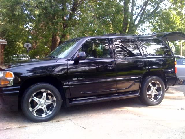

Looking for suggestions on my AWD Denali. It's an 01. Currently it has blown out rear shocks. Looking at purchasing the following shocks but I am not sure if my factory compressor even works any more. The service ride light has been on since I bought the truck and there are clearly visible rips in the rubber on the rear shocks.
http://www.arnottindustries.com/part_GMC_Air_Suspension_Parts_yid15_pid95_gid509.html
What I am looking to do is lower it a few inches and get the suspension all in working order. I remember seeing a kit a while back that eliminated the autoride but I cant find it now, seems like it might be a good solution to having to worry about more shocks failing.
Anyone wanna recommend solutions?
Here's a couple pictures of the truck currently. Located in Tampa area currently.. would prefer local shops if at all possible, but would order online. No problems installing myself.
