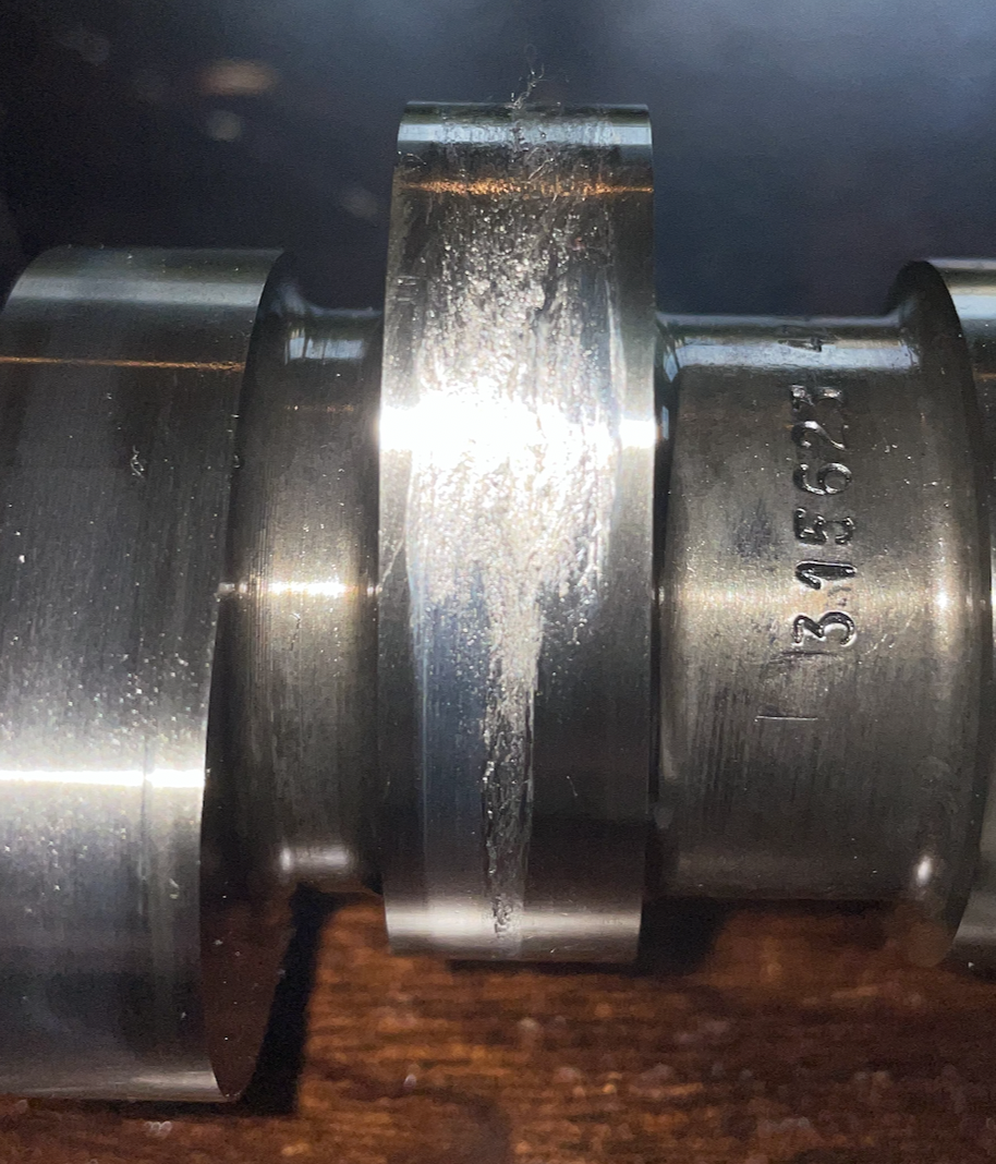

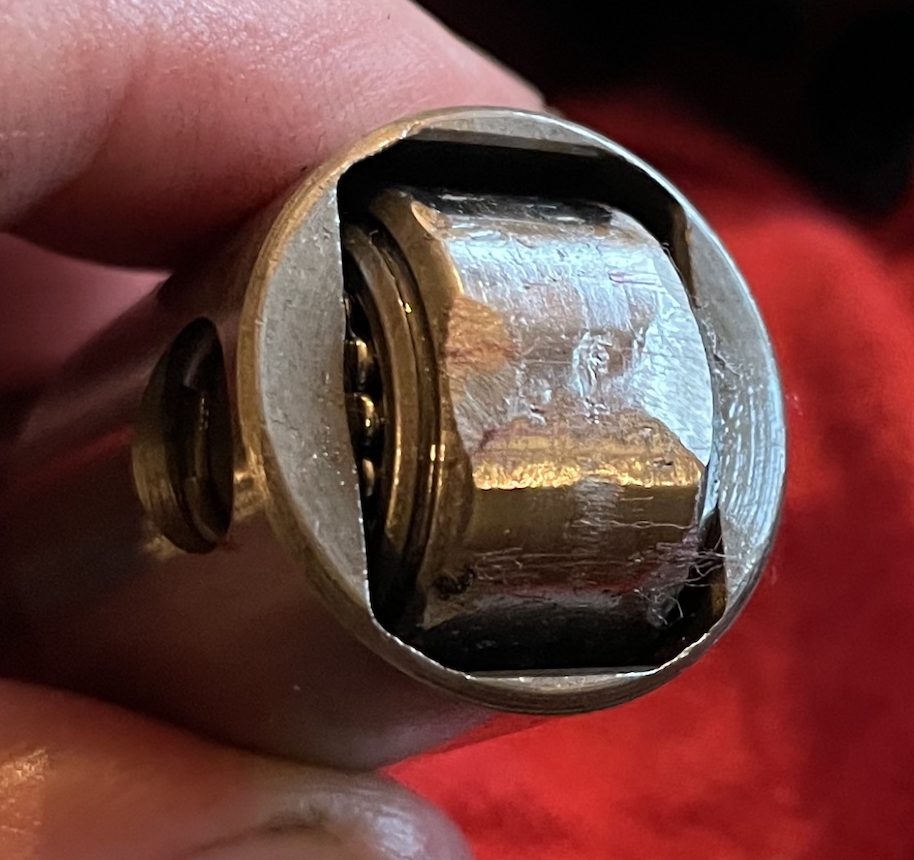

Here's what mine sounded like with a failed non-AFM lifter. The damage was caused by the lifter twisting in a poor quality aftermarket lifter tray.
