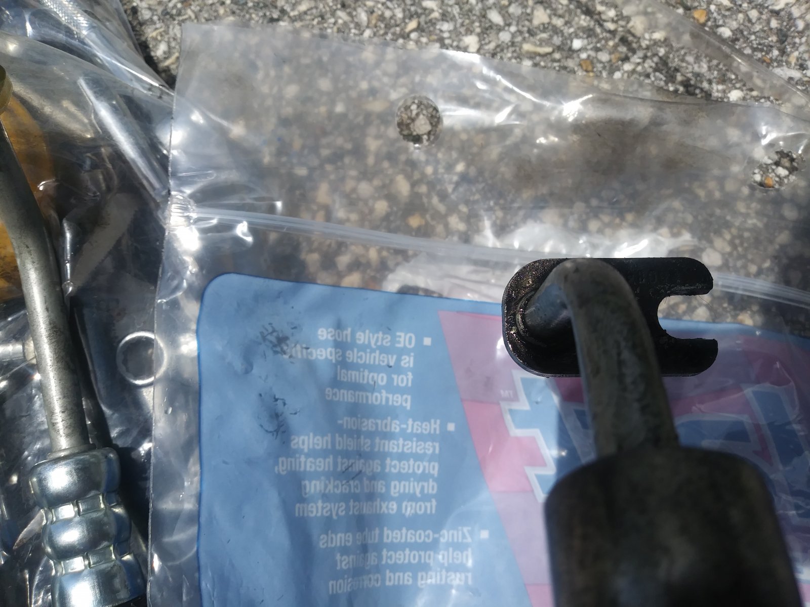

Some (bad) pics of old and new part

He's what I put on our 07 Denali almost 4 yrs ago:
Trans cooler line 1 – ACDelco 15779543 - $16 amazon
Trans cooler lines 2 – ACDelco 25999420 - $56 amazon
Trans cooler clips- ACDelco# 24205103 - $10 amazon
Our RPO code for the factory trans cooler in KNP.
