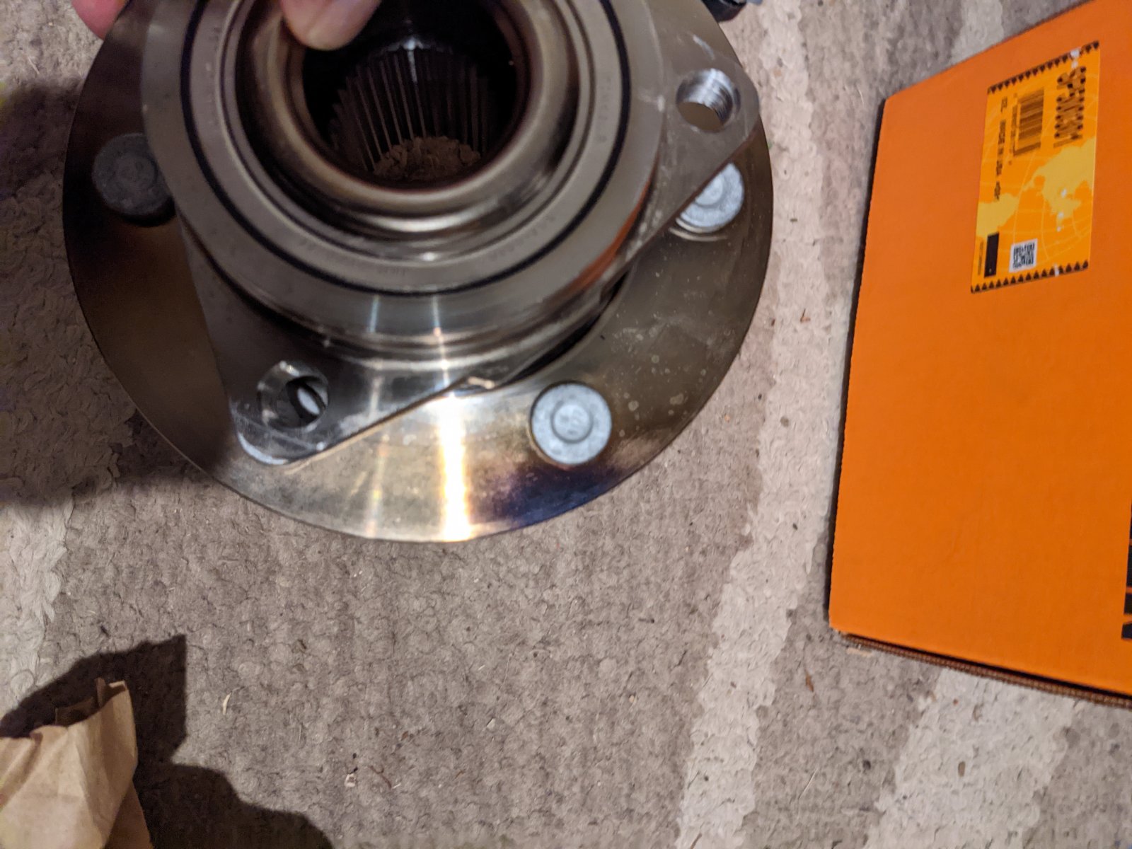

Bad Timken Hub Asembly?

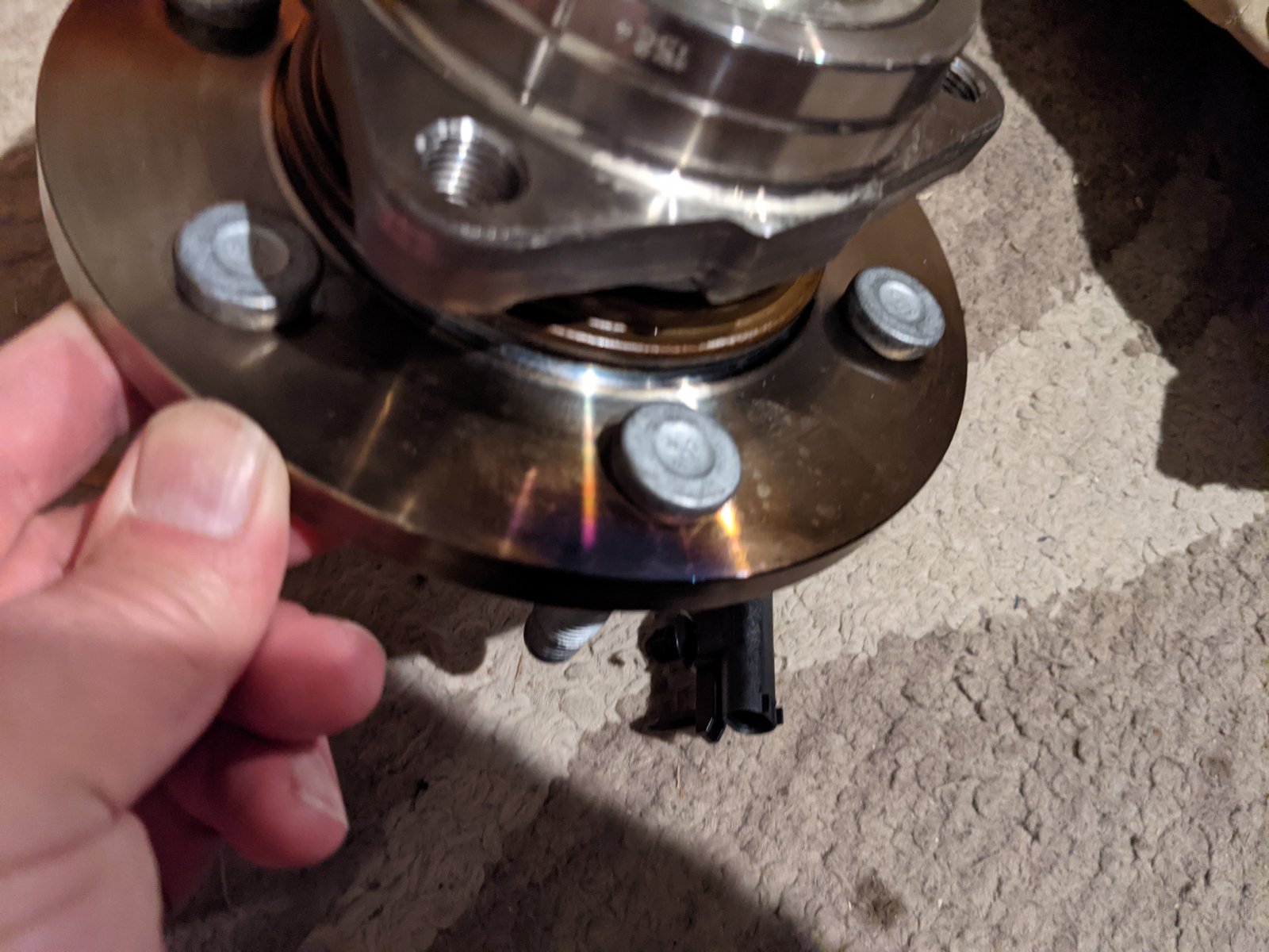

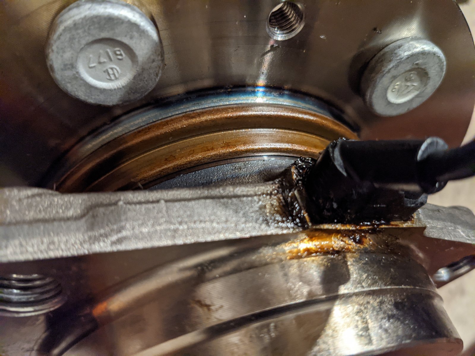

Grease looks cooked and should not be there.
Perfect! That's the answer I was looking for! I thought that grease should not be there, too, but was not sure because I had not replaced a hub and wondered if this is what is like coming out of the box.

I ordered Timken hub from RockAuto before, the hub was Made in China, but it had decent shape.
For your "Made in USA" hub from Amazon, it is highly knock-off parts from China.
Also, contact Timken customer service and send pix to them, let them know the China made knock-off item being in the USA market.
The parts were tamped with Timken and Made in USA. I can't order anything from Rock AUto because they won't ship to my location - they won't pay the state and city tax seperate.
Lovely.
Well, sending back the Amazon POS parts and going to try Summit. Unfortunately, I can't use Rock Auto since they won't ship to my state (Colorado).
