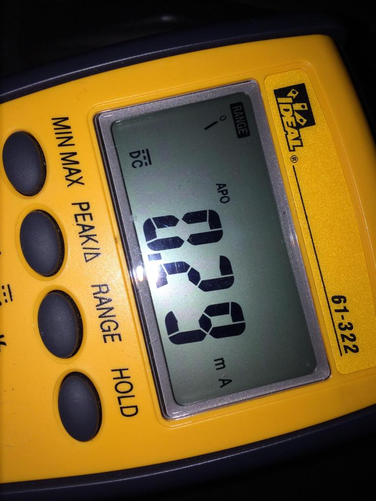

Ballaholyk84
Feb 20, 2013
22
I appreciate the help. SO I hooked up my Meter to the Neg Cable and the Neg Post and this is what is was spitting out to me. I pulled every fuse on the side of the dash as well as all the fuses under the hood. Nothing changed what so ever. I pulled the Neg from the Alternator as well and nothing either. What would be the next step from here?
