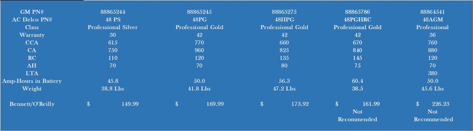

Walmart is out of batteries because they are changing skus and prices are doubling, an $88 battery for the Montana Saturday night was now $125 or so on Sunday. We went to O'Reilly's and put an $88 ACDelco battery in it instead. I can't imagine that car last another 18 months! But then again, I thought we'd only have her another year, 6 years ago!
Anyhow, the 42 month ACDelco 48PG is $166.99 at O'Reilly's right now and the 48HPG is $173.99. The latter has a higher reserve capacity (15 more minutes) and a little more than 6 amp hours more juice in it.
I think it great that you got 7 years out of any battery. Down here in Florida we were lucky to get two years out of them before RVC was put into the cars. My last 30 month ACDelco battery went 48 months, 48K miles and 1700 hours. It was replaced with a 48HPG last Christmas.
The charging systems in the 900s were not programmed to handle AGM batteries and judging by the comments on this and other forums, they do not last as long as they could have because, if memory serves, they like to be re-charged at a faster rate. This may be why GM uses 220 amp alternators now. ACDelco makes AGMs too, but they are not listed as compatible with our trucks though plenty of folks use them without issue.

I didn't get the chance to strand her. I offered to make the hike home but she phoned a friend down the road so I missed my chance!
I have Oreilly's checking to see if they can get those AC Delcos. They are on their website but as an "order" item.
I will definitely go down that road again if they can get them. Mine is the 48PG. I see from the chart that the HPG has quite a bit less CCA and we get a cold winter here.

The rating for our cars was 600-615 cranking amps but you might want to stick with the 48PG again instead of the HPG. In Florida it's not as critical.
Anyhow, 84 months on a 42 month battery, you done good! I'd say you got your money's worth!
