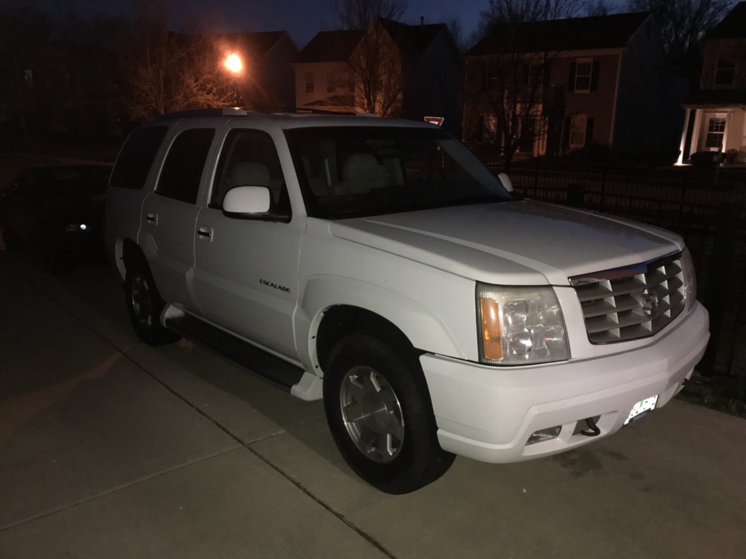

Decided to o ahead and rebuild my engine. Right now I’m trying to decide if I want to hop it up while it’s going to be torn apart. Haven’t decided on L92 heads, as replacement LQ9 heads are dirt cheap and would let me keep my intake.
As far as the cam goes, is there a good cam that would up the power but still idle smooth and keep it easy to daily? I was thinking maybe an LS6 or LS7 cam.
