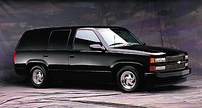

how do you think the belltech 3/4 drop kit with nitro drop shocks will look on my 2000 tahoe limited OBS?
thinking about getting this kit...and eventually the same wheels i have on now but in 22's. If i lower it will i need smaller tires so they dont rub on anything? Right now they rub a lil on full lock

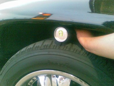

i have a 3.5/4 drop on my hoe on 18s also. Im running 255/50/r18s. I like it but what people dont tell you is that you have to relocate the rear break junction block on the rear axle. Maybe it was just mine but it was hitting my driver side tail pipe

when i droped on my old tires. 285/60/18 toyos i hit the fender on every little bump. So i rolled my fenders and they still hit. You till need a skinnyer tire for sure. Or a new offset

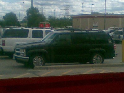

Here is my old 3/4
Alot lower
How it sits now

^^^More of how it sits now :D Is that static? If so damn, it must be hard to drive that thing LOL I used to scrape my frame on my ECSB OBS truck when it was dropped 5-7 and I'm pretty sure that your lower than 5-7
