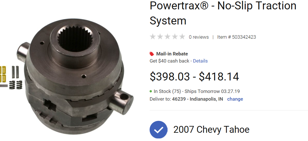

Does anyone have any experience with this? Some of the claims are large, is all of this true? I will list them below.
https://www.carid.com/2007-chevy-ta...submodel[]=WHEEL+DRIVE|4WD+(Four+Wheel+Drive)
Enables a 2 Wheel Drive to outperform a 4 Wheel Drive in poor traction conditions
Gives 4 Wheel Drive vehicles ultimate traction performance
Maximum power to both wheels off the line and in high g turns
Torque transfer limited only by the strength of other driveline components
Dreaded wheel spin is eliminated
Smoothe and Quiet OperationSynchronization mechanism eliminates ratcheting sound typical of locking differentials
Backlash effects are minimized because of special spring/saddle design
Takes 6,000 to 36,000 ft-lbs of torque.
Much stronger than the axles
Improves driveline durability by eliminating wheel spin and the associated driveline trauma
Zytanium construction is 67% stronger than titanium
No wearing surfaces. No friction clutch packs to burn out
Easy to Install Installs in the existing differential case- no need to reset the ring & pinion
Is this real? These are tall orders. I am investigating this further for the rear end and
I would never put a locker at all on an IFS front end, but I am curious about this, I am going to try and talk to the manufacturer.
Does anyone know anything about this?
