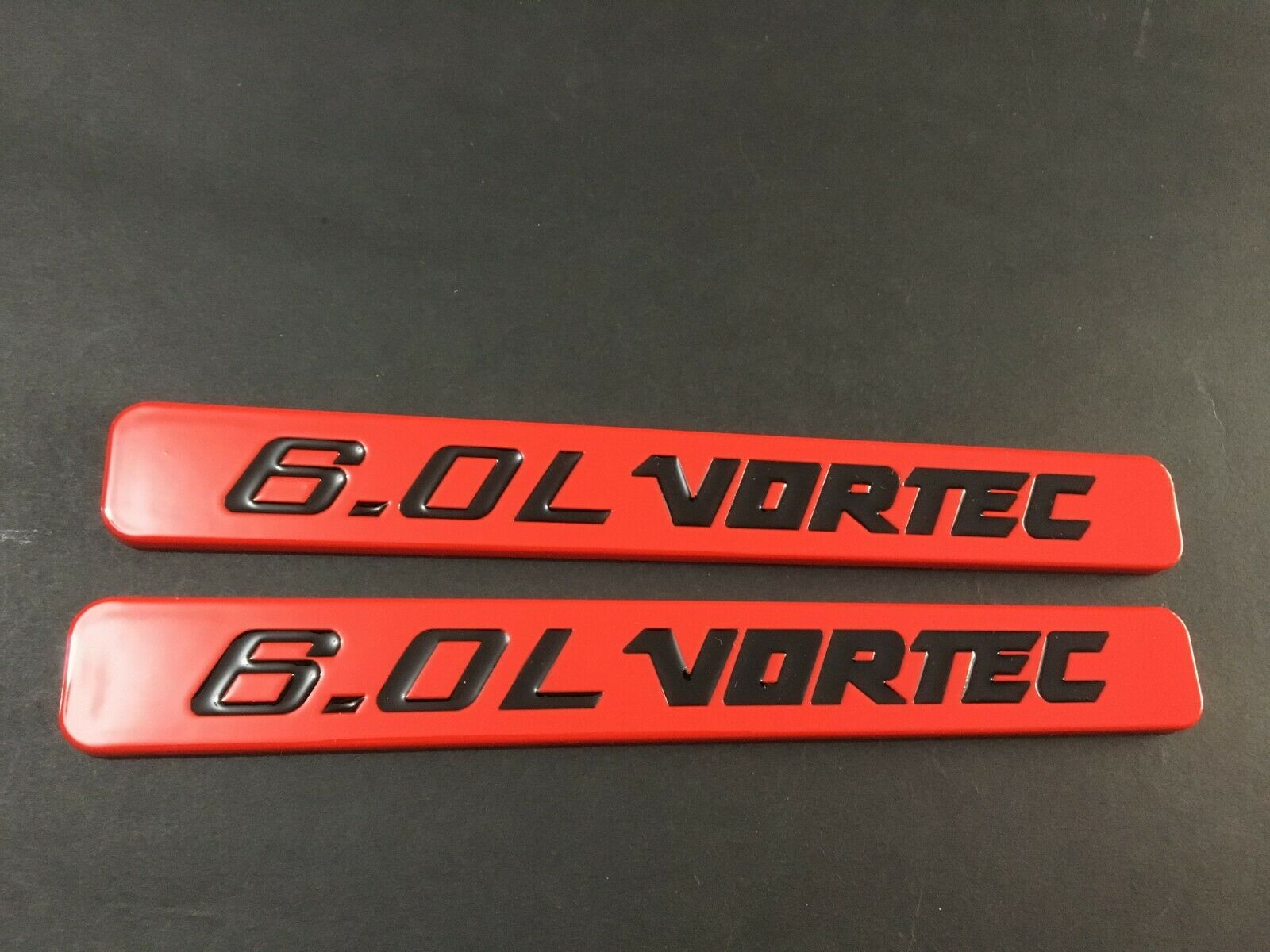

6.0 $2529 + core
317 heads (those arent bad if you shave em)
That's a smoking deal too!
Warranty is void with improper installation, which probably means NO 6.0s in place of 5.3s (if they find out)
But they don't know because you pick up and drop off if failure occurs. Gray area....I'd go 6.0L, sell your short block, eat the core and live dangerously LOL!
No LBZs..... :-( Booooooo
Why do you need a tune?
You thinking 6.0L?
