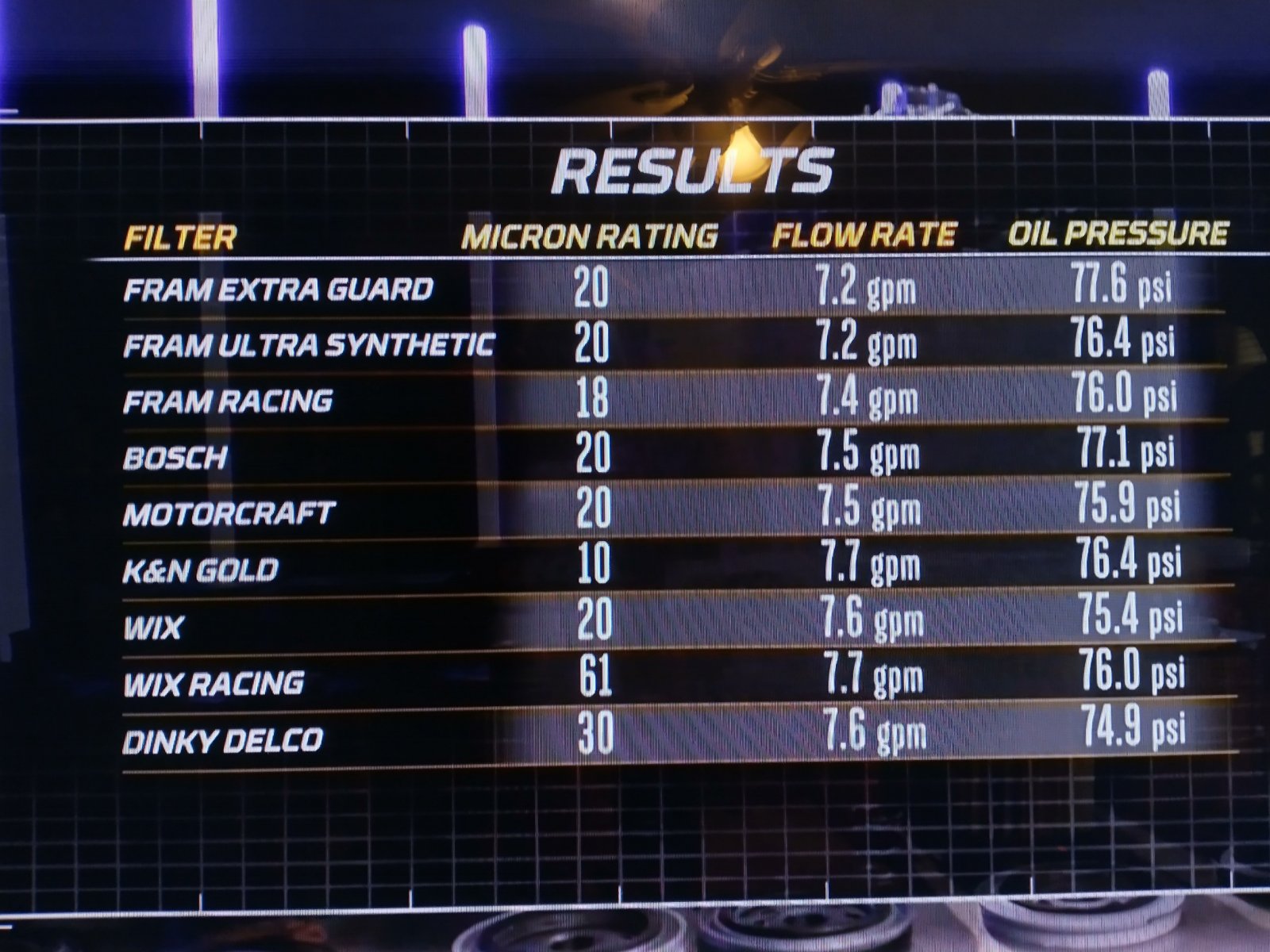

@swathdiver Please provide a link to K&N oil filter data.
That was seven years ago, don't remember anymore, Don. Maybe they've since revised their data?
Though my memory is not great, I don't remember any mention of an ISO standard during my research back then.
Back then I made a huge list and began compiling the data and then stuck with furthering the research/data collection on what appeared to be the top filters. As usual, there was nobody to peer review the research/data so errors are possible/probable!
