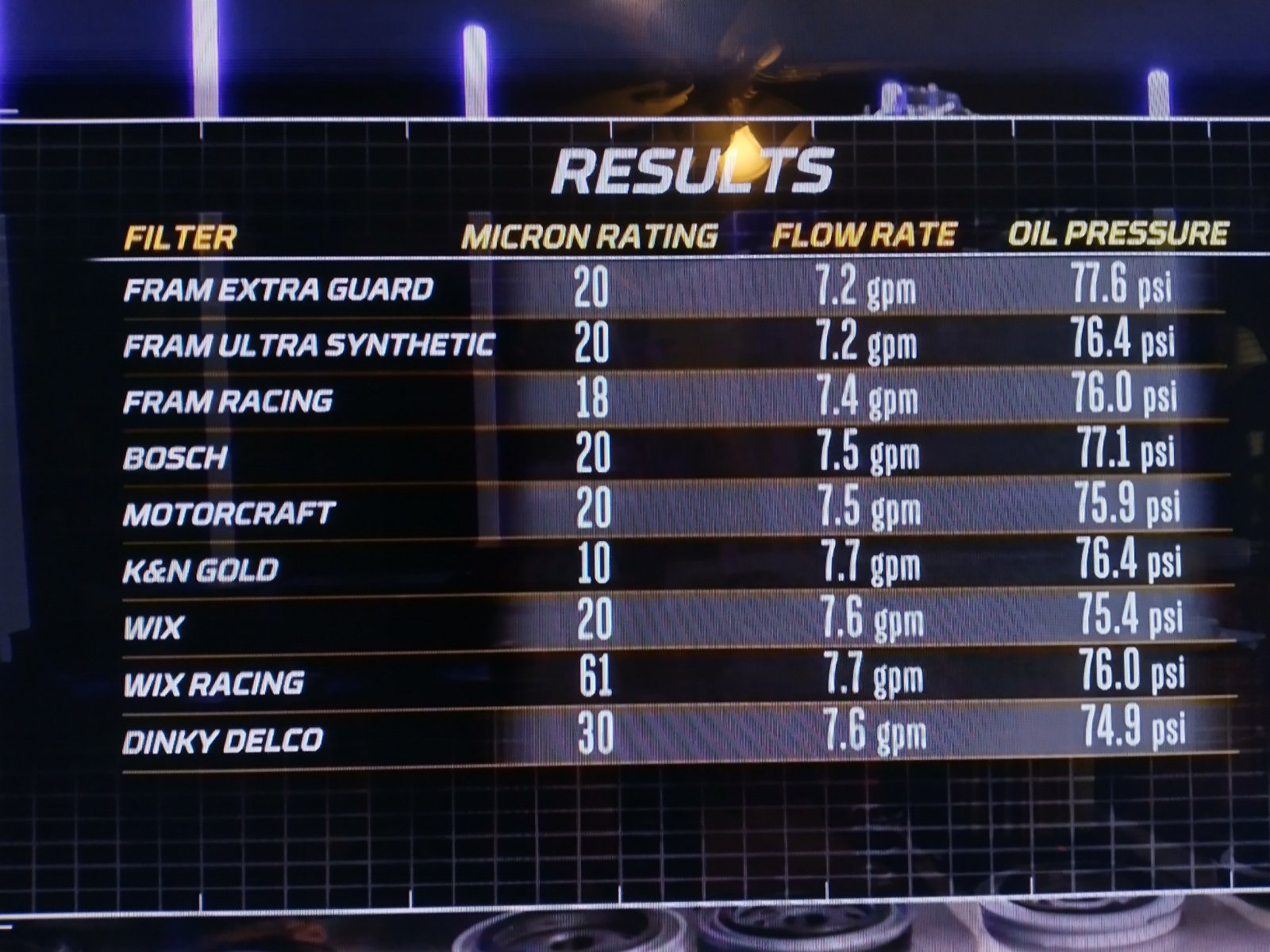

If you are a gearhead like me, Google Engine Masters from Motor Trend TV. They did a very informative episode on oil filters. I think they tested like 10 . Too bad this show went away as it was one of the best Automotive shows out there!!
I agree. Steve Brule retired, and I think MT ended all its shows.
Here's their chart, off my TV.

I wasn't criticizing, I just didn't understand.
Based on this chart, I'd go with the K&N if I was after "ultimate"; it has the tightest filtering and the most flow and pressure.
They're all so close though, that I don't worry about it. I have faith in regular oil and filter changes.
